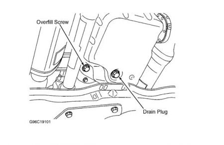

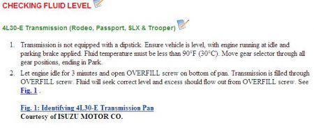

How to check transmission fluid level and I cant fund the depstice location thank you

Hi there, There is no dip stick, the oil level is checked at an over flow plug see text & pic.
