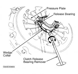

Clutch release bearing keeps popping out of pressure plate. What am I missing?

Is wedge collar in place on cover?

Yes the wedge collar is in place. It keeps popping back out.I can feel it snap in good. Bad wedge collar? Thanks doc>>>

Tea they get worn if it can't hold bearing then replacement could be the fix
