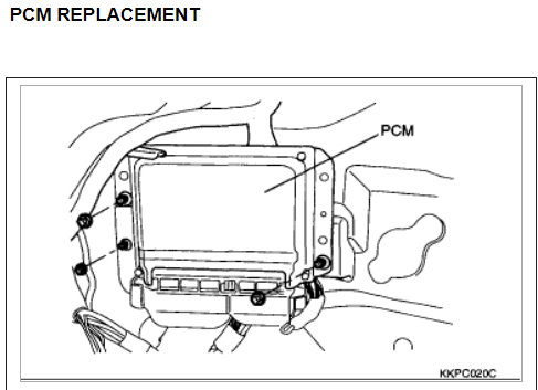

Car will start and run. But with the car in drive it is only in 3rd gear. One tech said that it may be the computer, is not telling it what gear to be in. Could it just be a electrical issue. No problem till a check engine light came on the other day. It is not the fluid level. Thanks for your help. T is the 08 accent hatchback, the base model, automatic

An error has been detected by the transmission control unit and it is now locked in the Limp-mode.
You need to have the trouble code retrieved and find out what is causing the problem.

This sounds like a transmission pressure solenoid that is going out and needs to be replaced but to be sure lets run the codes to confirm the failure.
Here are the locations of the solenoids if needed. Sometime codes wont come up for this problem.
Also I have seen where the PCM can fail causing this issue as well.
+2
Wednesday, October 30th, 2019 AT 5:49 PM (Merged)
NANNY
Thank you for taking the time to help me. I thought I would let you know what happened. I took it to a shop and they changed out the PCM for a tune of $450.00 but at least the car is running.
Thanks again!

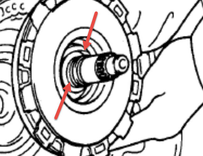

At morning I start the engine and drive for a while the automatic transmission not shifting I think it start at third gear and still until I switch off the engine and start again, then automatic transmission works normal.
HMAC300
  • 48,601 POSTS
Check fluid level and have a trans guy scan for codes it may be a seal in cluch pak not working til it heats up
Wednesday, October 30th, 2019 AT 5:50 PM (Merged)
ALROUSAN
Thank you for your response I check the fluid level its OK but when I remove the Automatic transmission pan I found some metal swarf, then I return the same oil and close the pan again
the mechanic told me that gear number four is worn out but I don't trust him.
HMAC300
  • 48,601 POSTS
Itf the metal you found in your pan was just like dusty style but wet then that is normal. If it's larger pieces like small shavings then there is a problem inside and can be a thrust bushing going or bearing. It may be moving to far on shafts causing your problem. To where the seals on the shaft are not holding well. See pic arrows point to seal as an example. If thrust bearings are bad you end up with to much end play in shafts so it skips gears
ALROUSAN
Dear Sir
Thank you
it's a large pieces like this (-) and no skips gears it's just stuck at number three gear and then not go to four and not going to two gear either until switch off the engine and start again then every thing back to normal.
HMAC300
  • 48,601 POSTS
If it's large pieces then it's gonna be time for a rebuild
