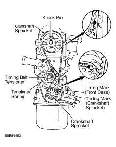

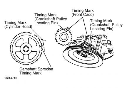

I am trying to locate a diagram to set the time marks when installing the timing belt for a 1995 Hyundai 1.5 liter Accent.

BLUELIGHTNIN6
MECHANIC
16,542 POSTS
SPONSORED LINKS
+3
Friday, August 13th, 2010 AT 5:30 PM
