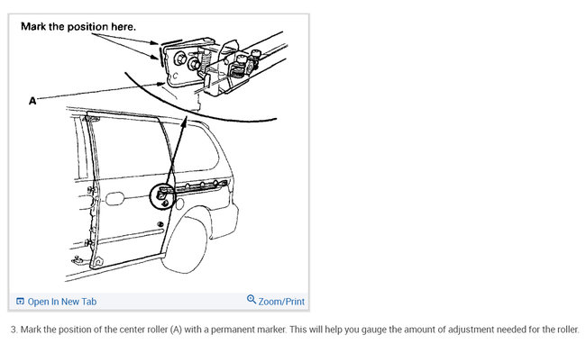

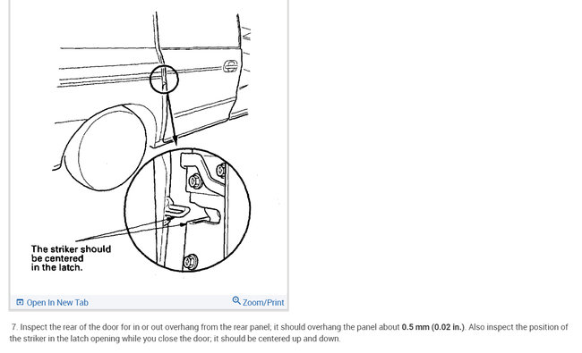

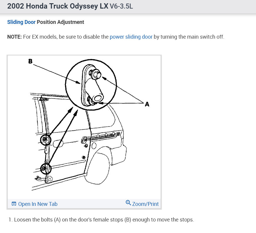

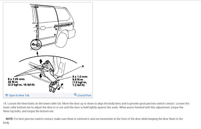

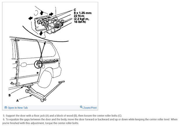

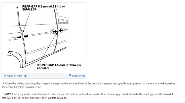

  • 2008 HONDA ODYSSEY

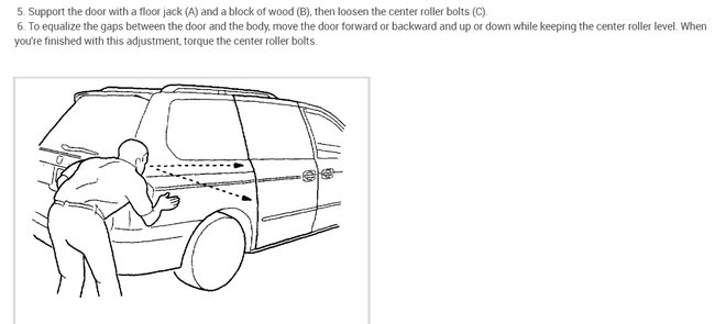

I accidentally backed out of my garage with the passenger side sliding door opened. It hit the garage and came off track. My husband got the door back on, but it won't close properly. It will close all the way, but you can tell that it is still not right. Is there a way to get it back on correctly, or was something inside the door bent or broken? Will it have to be repaired at a Honda dealership?
Saturday, August 16th, 2008 AT 8:26 PM
32 Replies
KHLOW2008
  • 41,815 POSTS
Hi leslou,
Most probably something has been thrown off track/bent/out of alignment due to the accident.
To get it back to working order, some adjustment/parts replacement would be necessary and you can try your local body repair shop for adjustment first.

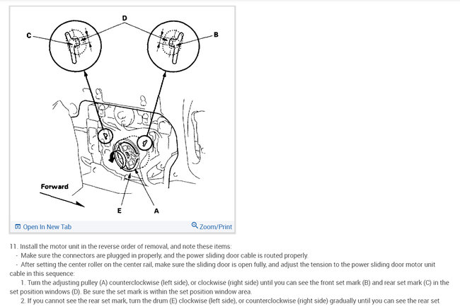

Here are the manual releases for the sliding doors and the rehoming procedure as well:
Re-homing the Power Sliding Doors

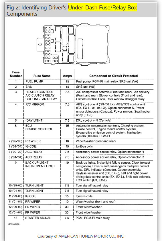

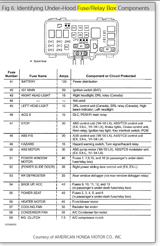

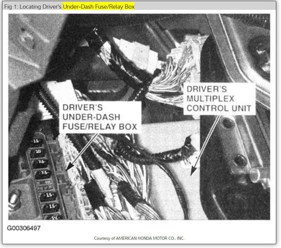

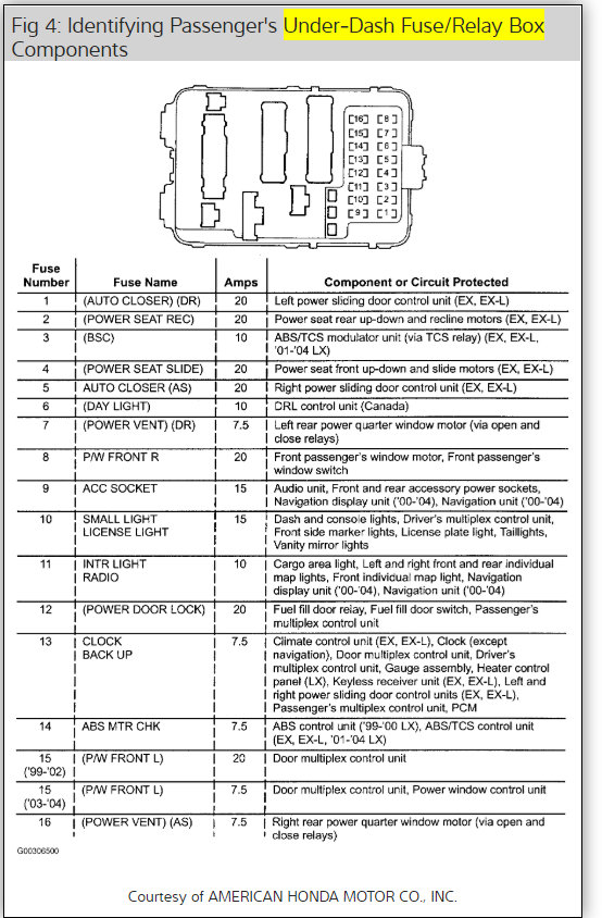

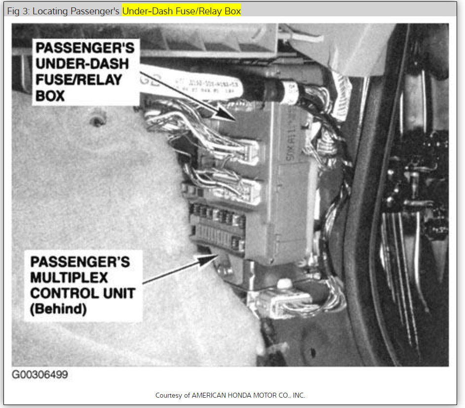

Have you looked at the fuses? here is a guide and the fuse panel location and identifications below:
Check out the diagrams (below). Please let us know what you find.

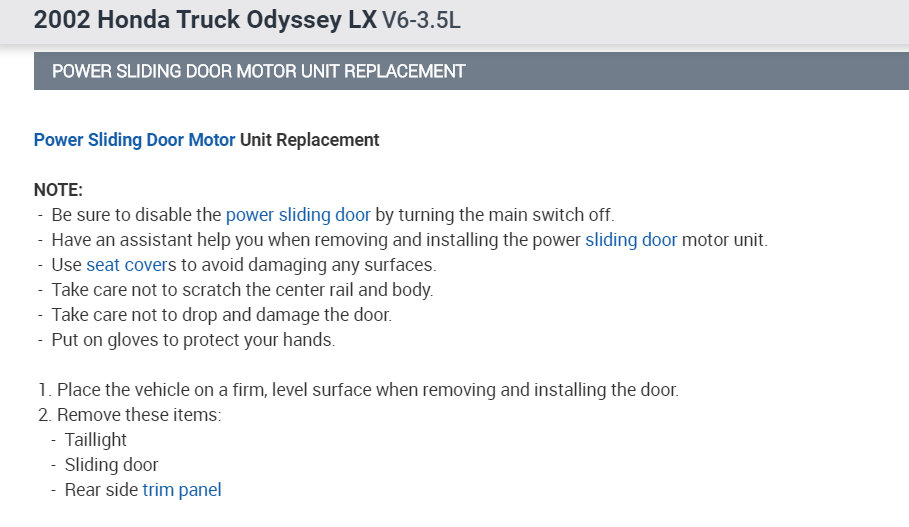

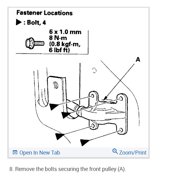

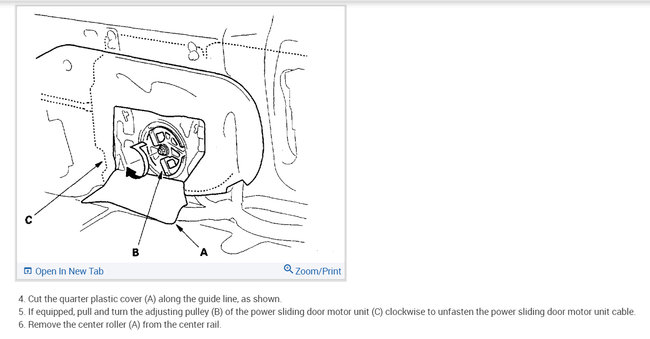

BORISBADENOUGH

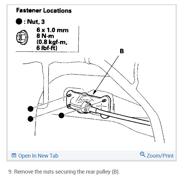

Ken, THANKS for your reply. I am going to save your answer because it will come in handy in the future, I'm sure. Since I wrote in, I was lucky enough to discover the problem. Until this moment, absolutely nothing I tried manually or electronically worked to budge the door. I finally had the door and adjacent panels completely off to examine everything part by part; and then I pulled off the door motor spools. Hidden beneath the spools was a small tangle of cabling, binding up spool and motor shaft, locking up movement in the entire system. Apparently, the cable rusted and broke very near the center of the spool, hidden from view and the rest of the cabling one could see. So for example, under the exterior cable trim panel the cabling looked fine, tension existed as it normally would (because it was actually just tight against the inner spool.
Thanks for taking the time to respond. I really appreciate it. I have to say I got very different advice locally from Honda experts. One Honda "master mechanic" suggested the problem was likely a stuck/broken latch assembly; so, to get the door open, ". We sometimes have to just start drilling through the inner metal door frame and then into the latch assembly, and it would then "release" the door if one drilled here and there until you hit the right spots". Glad I didn't do that one!
+1
Monday, October 28th, 2019 AT 10:39 AM (Merged)

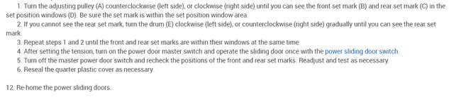

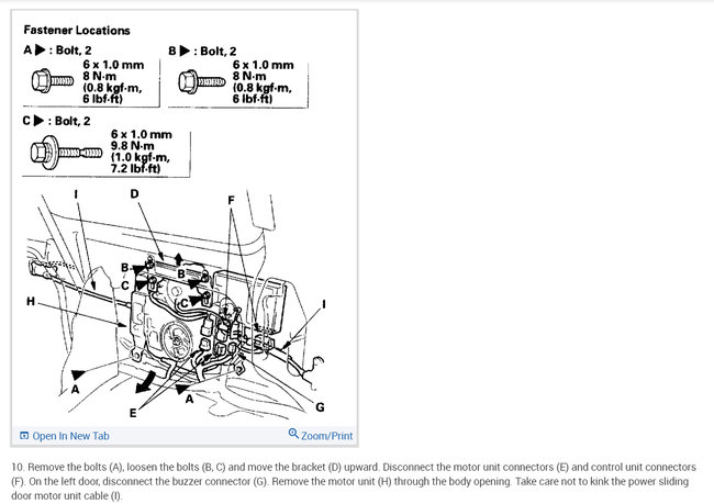

KEN L
  • MASTER CERTIFIED MECHANIC
  • 42,878 POSTS

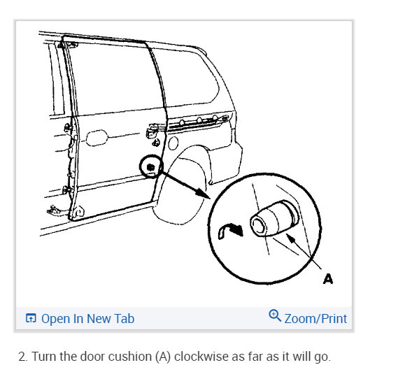

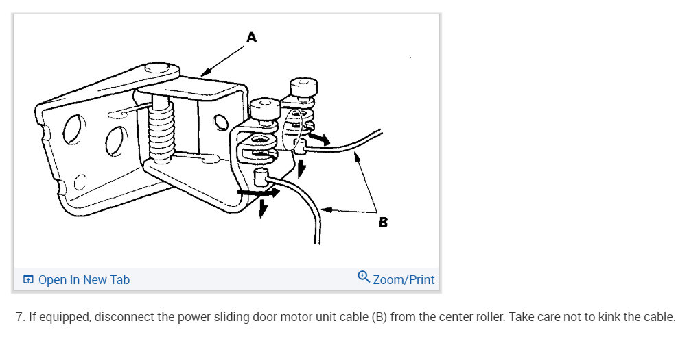

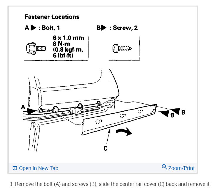

Me too! Here is the remainder of the repair diagrams for the door cable. Read through the instructions before you begin. Check out the diagrams (Below). Please let us know if you need anything else to get the problem fixed.

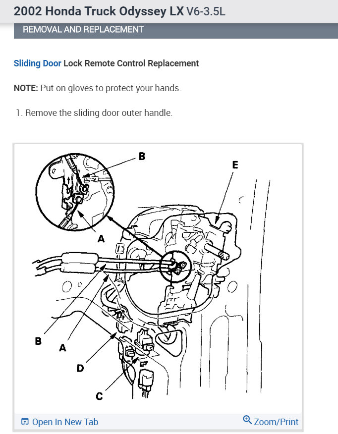

The slider door on drivers side lock latch is stuck in lock position, making the door unable to close. What do I do?

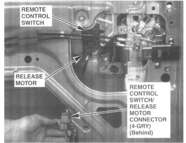

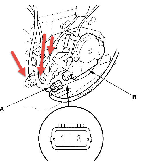

HMAC300
  • 48,601 POSTS
Try lubing it up then put a large screwdriver in it and see if it will latch on that if it does then work it back and forth a few times should be ok then.
Monday, October 28th, 2019 AT 10:40 AM (Merged)
DBOUGE
Got lock unlatch. Can now only manually close the slider due to no power. When I hand shut the slider when in off position, and pushing shut, the door engages to lock position, but nothing else happens, and nothing once flipped to on position. The other slider on passenger side has power working. Idk what to do cuz already did fuse checks and troubleshooting no luck, battery cables etc etc but no luck.
HMAC300
  • 48,601 POSTS
Check to see if yo can hear lock functioning when you try to power it if youcan it may be a clip broken and rod or cable has broken. See pics also try a reset otherwise the car will need scanning by a pro to see if something like a sensor is bad.

I see the fuse box located under the steering wheel, but I do not know what fuse I should be replacing, and since our car was bought used, we do not have a manual.
Can you help me out with telling me where I can find a picture of the fuse box - or could you indicate what fuse it is I need to change?

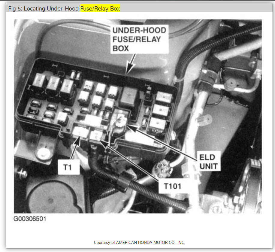

EMJOHN
  • 6 POSTS
There are several fuses.
Primary under hood fuse box is located in the back or the engine compartment on the passenger's side. Check fuse # 11, 30A.. Secondary under hood fuse box is located next to the battery. Check fuse # 1, 30A.. Passenger's side interior fuse box is below the dash on the kick pannel. Check fuse # 1, 20A, and check fuse # 5, 20A.
