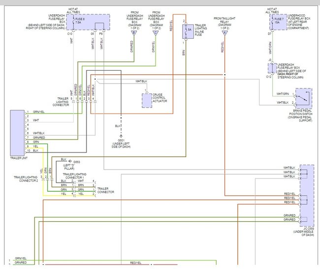

Replaced battery. We heard buzzing when we started car. Replaced starter relay, it would not start. Replaced starter, it started, put into gear (R) shut off and will not start.
Tried security steps with key fob, would not start. Attempted "clear flood" accelerator was stuck on floor pulled pedal up and tried the step, would not start. Turns over will not crank. Pulled spark plugs cleaned them.

No. Everything is installed properly. It started the one time, but when I put the car in gear (reverse) and move less than a few feet, it shut off.

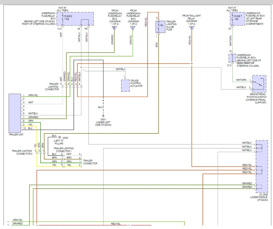

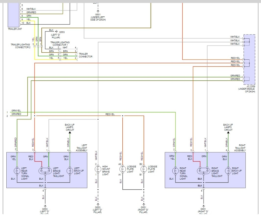

Compression isn't the issue. Pretty sure it's either electrical or gas related. Also, gear shift won't shift from park to neutral without using shift release slot. Brake lights aren't working. The fuses appear to all be good. About to the end of my rope with the care. :-D
Thursday, January 2nd, 2020 AT 6:58 PM (Merged)
KEN L
  • MASTER CERTIFIED MECHANIC
  • 42,904 POSTS
Hey FMARSH2005EL,
There is a power junction block and a tail light relay that could be causing the problem, here is a wiring diagram that should help you test for power along the circuit.
Run some tests and get back to us so we can continue helping you.
Best, Ken
