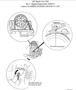

My timing is off, I looked at the notch on the cam gear?
i set it to the top but I cant get the harmonic balancer off to see where to set the bottom thing tranny?

Hi siickfreak420,
Here are the diagrams for the timing marks.
