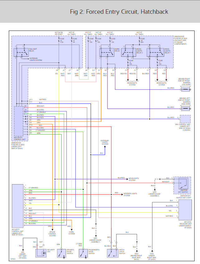

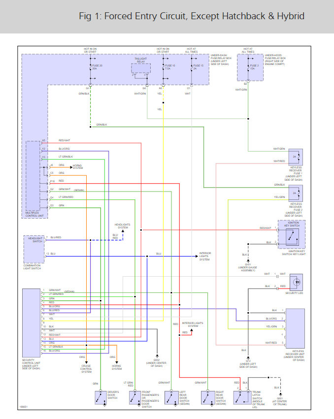

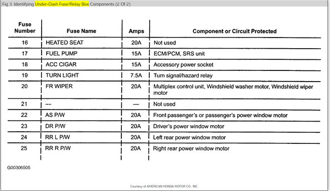

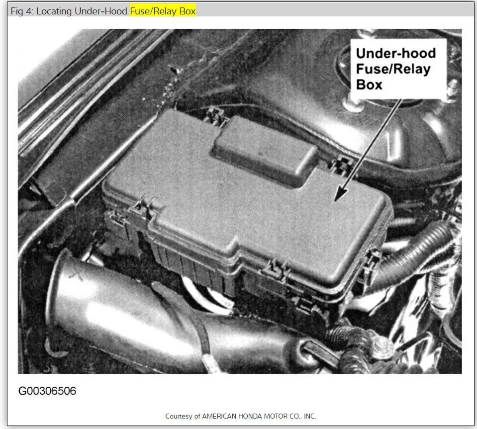

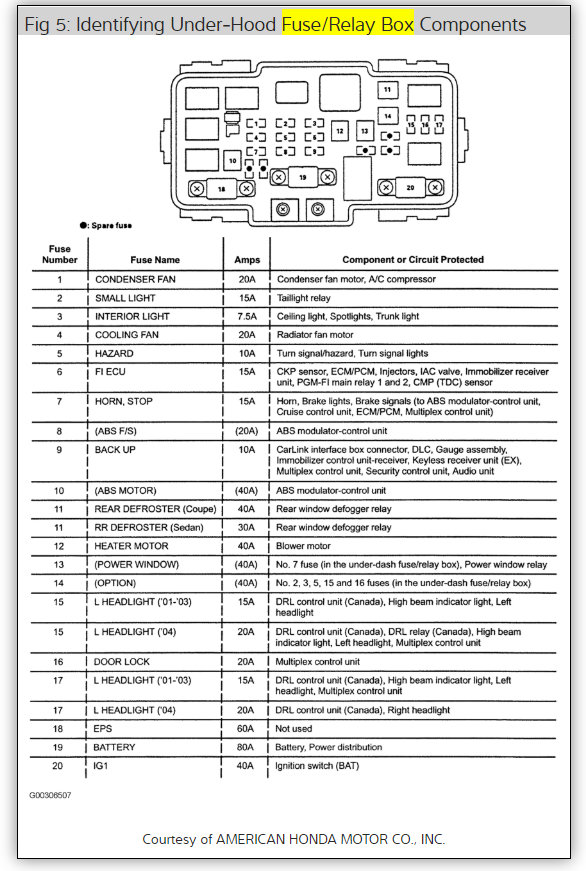

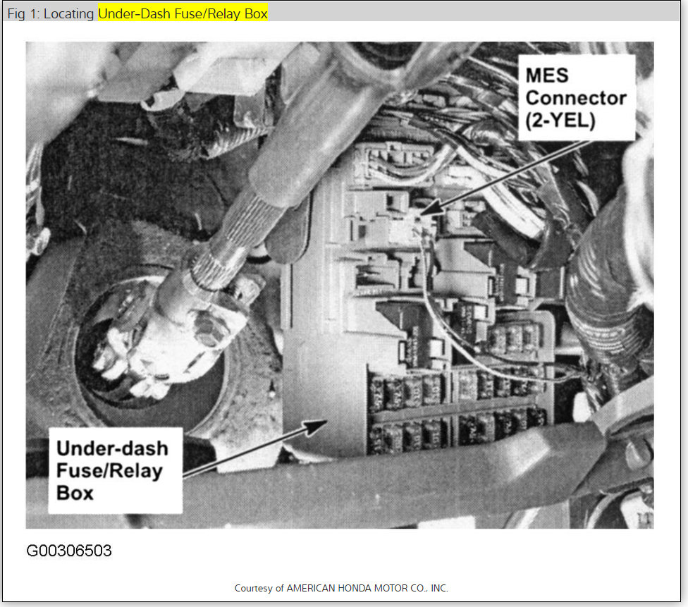

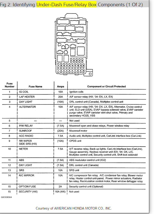

There are many fuses that run the system. Here is a security system wiring diagram so you can see each fuse and a guide to help you check them:
May 13, 2018 at 11:20 AM
BRADIX
  • 9 POSTS
Which fuses would I check?
May 13, 2018 at 11:30 AM
  • CAR REPAIR CONTRIBUTOR
  • 54,350 POSTS

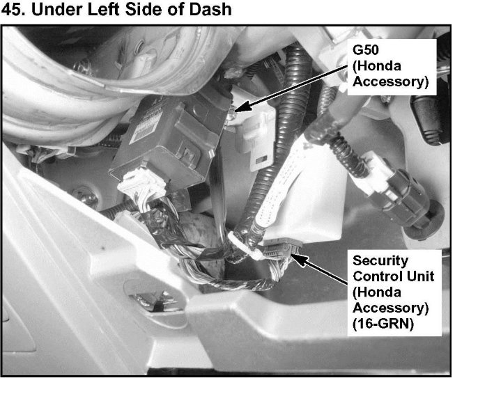

20, 12, 10, 15, and 2 if they are all okay it sounds like the alarm module is going out which will need to be programmed by a shop. Can you see the fuses in the wiring diagram or are they too small to see?
Here is the module location. Check out the diagrams (below).
May 14, 2018 at 9:42 AM

I ended up disconnecting the harness of the security unit, central locking horn honk is now back again. but alarm disabled now. I guess it must have been disconnected the whole time after I got the car from the previous owner.

I doubt it was disconnected as you had to disconnect it to get the system to honk. More likely is that something in the alarm unit failed and was blocking the horn signal.
Or one of the inputs to the alarm failed and wasn't turning it fully off.
