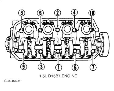

Please send me the head bolt tightening sequence 1993 honda civic 1.5l 16 valve single overhead cam.

Cylinder Head Bolt
D15B7 & D15B8 Engines
Stage 1 22 ft.lbs
Stage 2 48 ft.lbs
