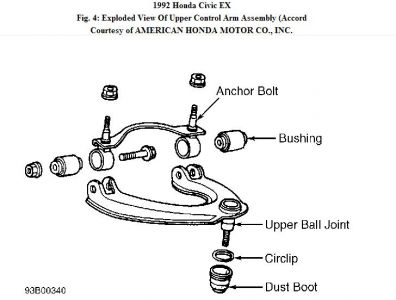

I just replaced my upper control arm bushings but I need to know the proper torque specs for the upper control arm.
Friday, March 6th, 2009 AT 9:45 PM
KHLOW2008
MECHANIC
41,815 POSTS
Hi jarchuletta,
Upper Control Arm Anchor Bolt Nut = 47 Ft.lb (64 N.m)
Upper Control Arm Bushing Bolt = 20 Ft.lb. (27 N.m)
Ball joint Nut = 32 Ft.lbs ( 44 N.m)
