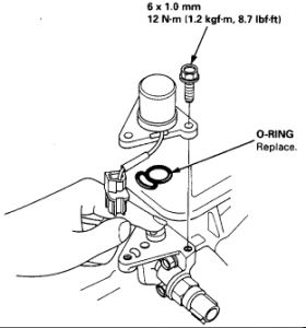

I have replaced the: valve cover gasket, distributor O-ring; and both gaskets on the V-tec solenoid on the back of the engine. The bottom of the v-tec solenoid has oil on it everytime after running the engine driving it like normal for 5 minutes. Could this be the main seal you were talking about? I think it might be leaking from somewhere else on the back of the engine but near the v-tec solenoid.

The VTEC is located on the cylinder head. My thought is it may be leaking out of the solenoid itself or the pressure switch that is threaded into the VTEC solenoid housing.
My suggestion since you have replaced the VTEC seals is I attached the info I have on that just so you can make sure you and I are talking about the same ones.
Next, there is a filter on the VTEC. . ...did you clean it?
Next - I would remove the pressure switch and place thread tape on it and put it back in.
Oil leaks are tuff. . .. . .once you have cleaned it. . ..use electrical cleaner for terminal boards. . .it is not as harsh and evaporates. . ...spray it all down really good so it is totally dry.
Start the vehicle and with a mirror and strong light just stare at it. Give it time. . .if you say it takes about 5 minutes then you know you need to wait at least that long. If you want, use the spray first and see if you can locate the leak before you take it all apart.
I show the dealer wants about $147 for the solenoid and about $68 for the switch. Again, it may be leaking out of one of these or the threads.

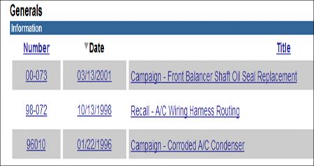

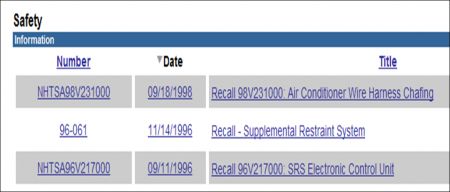

Oh, one last note. . ...you may have some recalls on your vehicle. The dealer may fix these for free. Please contact the dealer service department, give them the VIN number of your car and have them check on these to see if they apply to you. I attached them last.

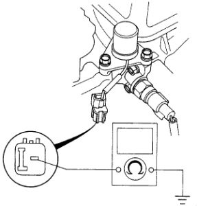

VTEC Solenoid Inspection
Notes
Disconnect the 1P connector from the VTEC Solenoid Valve.
https://www.2carpros.com/forum/automotive_pictures/248015_1_93.jpg
Measure resistance between the Terminal and body ground. Resistance: 14 - 30 ohms .
https://www.2carpros.com/forum/automotive_pictures/248015_2_54.gif
If the resistance is within specifications, remove the VTEC Solenoid Valve assembly from the Cylinder Head, and check the VTEC Solenoid Valve filter/O-ring for clogging.
If there is clogging, replace the Engine Oil Filter and the Engine Oil.

Ok, the part has stopped leaking. Here's what I did to fix it. When I tightened the solenoid back onto the car, I tightened the bolt on the bottom and the top bolt on the driver side more than the top bolt on the passenger side. This makes up for there not being a fourth bolt on the bottom driver side. Problem solved! Thank you both for your assistance with this problem.
