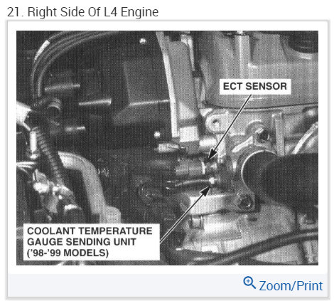

The other day I looked down and the temperature gauge was in the extreme "hot" position. I stopped the car and opened the hood. Nothing. The engine was only the normal heated. Coolant was okay and everything. The thermostat was just replaced a month ago. The fans are both working when the AC is on and cycle when the car gets hotter. What might be the problem?

It sounds like the engine coolant temperature sensor her gone out. Here is a guide to show you what you are in for when doing the job and diagrams below so you can see the location for your car below:
https://www.2carpros.com/articles/coolant-temperature-sensor-cts-replacement

That did the trick! Thanks for your help, I love this site. ;)

Okay, I am doing this for a co-worker. His dashboard temperature gauge was not showing proper temperature it would be all the way to C. After a long while it would move up down. He took it to the shop and was told he needed a new temperature sensor. They quoted him $100.00 to do the job. His question is, where is it located and can he buy the part himself and get a mechanic to put it in? Is that amount of money for the repair about right? Please advise.

$100.00 for that repair is extremely cheap.
The sensor is located on the right side of the engine. It only has one wire going to it.

The temperature gauge goes all crazy it flickers up and down and then suddenly stops pointing toward the H then flickers some more. It never stays still.
What can I do to fix this?
Is it an electrical problem or a sensor that malfunction?

It is most likely the temperature gauge sender.
Sender screws into block/head.
