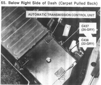

Where on a 1992 honda accord is the transmission control module (TCM) located.
Saturday, March 13th, 2010 AT 9:28 PM
MECHANIC
75,992 POSTS
Check out the diagrams (Below). Let us know what happens and please upload pictures or videos of the problem.
