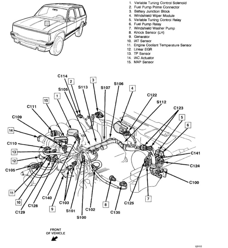

Engine surges while idling or running down the the road. Has new wires plugs rotor cap rotor button no vacuum leaks. New manifold temperature sensor valve. Fuel is clean, have changed the fuel filter twice.
Wednesday, December 2nd, 2020 AT 9:20 AM (Merged)
KEN L
  • MASTER CERTIFIED MECHANIC
  • 42,883 POSTS
Hey BEAVERWELCH
This sounds like a classic MAP sensor problem. This guide can help as well
https://www.2carpros.com/articles/engine-surges
Check out the diagrams below to show you on your car. Check out the diagrams (Below). Please let us know what happens.
