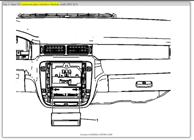

I have a 2007 gmc sierra classic crew cab. I started having problems with my radio this week so I decided to change out the head unit. Put a new one that is recommended for my truck and same thing is happening. First thing in the morning the radio only comes out of the small speakers in the front doors and sounds horrible. This lasts till about the same time every day around 11am. Any ideas of what can be causing this?
No amp. What has me stumped is that it worked fine last night and now it is doing the same thing the old stock radio was doing. Would putting it on a code reader maybe tell me something? My check engine light has been on for about 6 months now. Last time I did that they told me it said a part my truck supposedly doesn't have was showing defective.
The radio did not start working yesterday at all. In doing some research the only thing I have come up with is possibly the bcm. Is there any way to test this?
Thanks

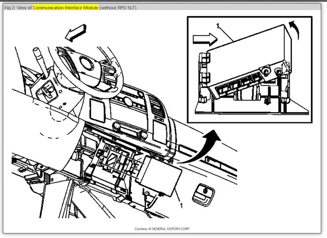

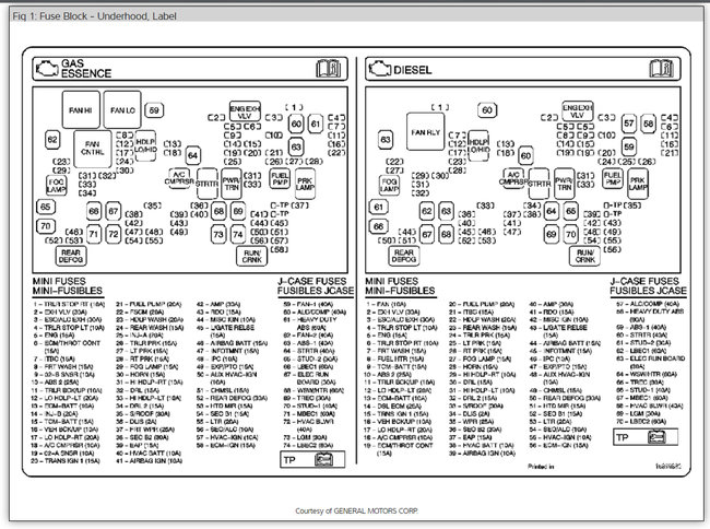

What happens is the communication module goes out causing the radio to stop at the same time as well as turn the check engine light on.
I would check all fuses as well, here are some guides and diagrams (Below) to help you get the problem fixed.
Cheers

Alrighty everyone! Here is what was wrong with mine. The speakers. They would come on intermittently but only in hot dry weather. I hooked up an old speaker I had, directly to the existing plug and it worked. I also tried hooking up the wires to the voice coil wires of the stock speakers and it still did not make the stock speakers work. The stock speakers will only work when hot. This tells me that something inside the speaker is not Scottish, so to speak. So, in my case, I am replacing my speakers. I will be sure to get back on here and let everyone know if something else goes wrong with it.

What i know at least about my situation is that in the beginning, all the speakers were intermittent and at one time, i even thought there was a pattern related to ambient temperatures. Finally, I did the communication module and it fixed the problem. I love this site!
