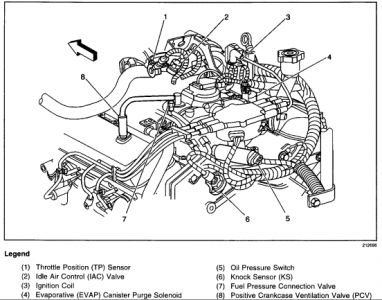

I need to knoiw exactly where the purge valve is located on my 99 GMC Jimmy. So I can replace it. Need visuals and walk through.

The purge control valve is on Top RH center of the engine, near the fuel injector connector
The canister purge control solenoid see item no.4 below
