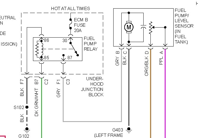

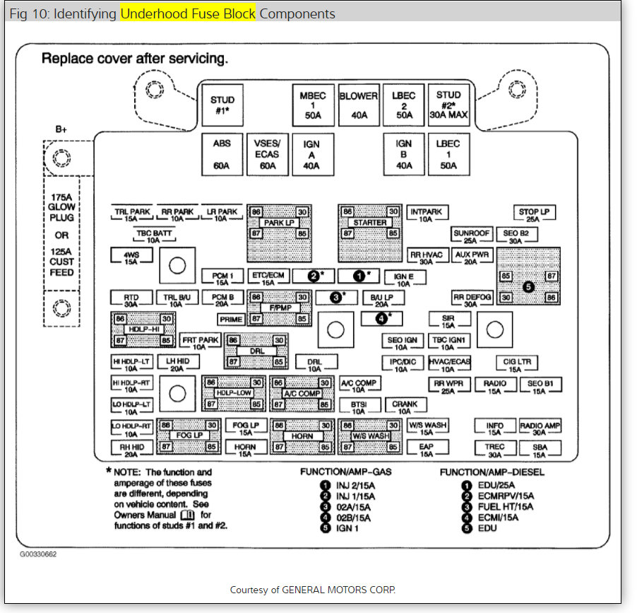

  • 75,992 POSTS
Check the ECM B fuse 20amp in the underhood junction block. If okay test or swap the FP Relay in the same location. If both okay.
Do this direct battery positive voltage to the fuel pump connector gray wire and negative post to the black wire -Did the fuel pump come On? If the fuel pump don't come on and the ground side of the pump is good=Replace the fuel pump-Good Luck
https://www.2carpros.com/forum/automotive_pictures/12900_fp1_20.jpg

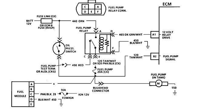

LOSONE

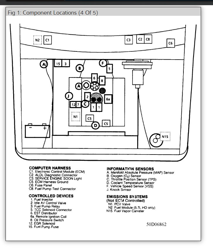

  • 1,616 POSTS
The fuel pump relay acts as fuel primer for between 3 and 9 seconds. The circuit is completed through the oil pressure switch when oil pressure comes up. If you are direct wired and the pump doesn't function replace the pump without question. Let me know here is the relay location and the wiring diagrams in the diagrams below.

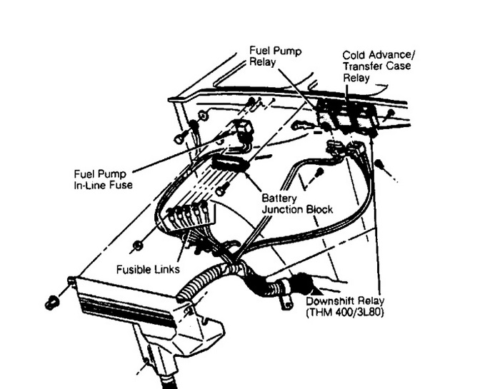

1990 gmc truck would not bust over when it got cold in the mornings but it would start up when it seemed warmer. One day when I got home from work I tried it and it did not start I put gas in it because it was low on gas and I started it and it ran. So I took and filled it up and the next morning it was cold and it didnt start up and has not since. I checked and it is getting fire to plugs, so I checked for fuel before the fuel filter and it was not getting fuel. Make the story short I ended up changing the fuel pump relay, fuel pump fuse, and fuel pump and still can not get any fuel, what could be the problem?
Wednesday, February 3rd, 2021 AT 1:26 PM (Merged)
JDL
  • 16,098 POSTS
Check the fuel pump inline fuse. Passenger side firewall. Picture below.
