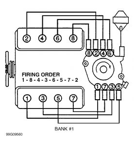

What is the proper routing for the spark plug wires for my surbburban

What engine size? 5.7L, 7.4L?
