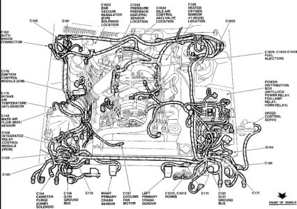

where is the fuel pump injector relay located on a 1994 thunderbird

Are you referring to the fuel pump relay-if so,see below:
The Integrated Relay Control Module is located at the RH front of engine compartment, mounted to upper radiator support.
