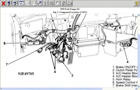

where is the fuel injection computer in the car and how hard is it to replace?

Before you start talking about the computer do below and tell me what happened. The computer is located behind left side of dash see below item no.8
https://images.2carpros.com/forum/automotive_pictures/12900_pcm_tempo_1.jpg
Disconnect a sparkplug wire or 2 and ground it to the engine -have helper crank engine over-do you have a snapping blue spark? If so-you have a fuel related problem, check the fuel pressure to rule out the fuel filter/fuel pump/pressure regulator and listen to the injector/s are they pulsing or hook up a noid light. No snapping blue spark continue to troubleshoot the ignition system-power input to the coil/coil packs,coil's resistances,cap and rotor /distributor pick-up coil, ignition control module, ECM,Ignitor cam and crank sensors- Note: If it doesn't apply disregard it
