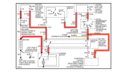

Put a new starter on and still will not start. When the key is turned on it just clicks.
Sunday, June 15th, 2008 AT 9:37 AM
MECHANIC
75,992 POSTS
Check all fuses involved in the start circuit-see below for possible causes-
