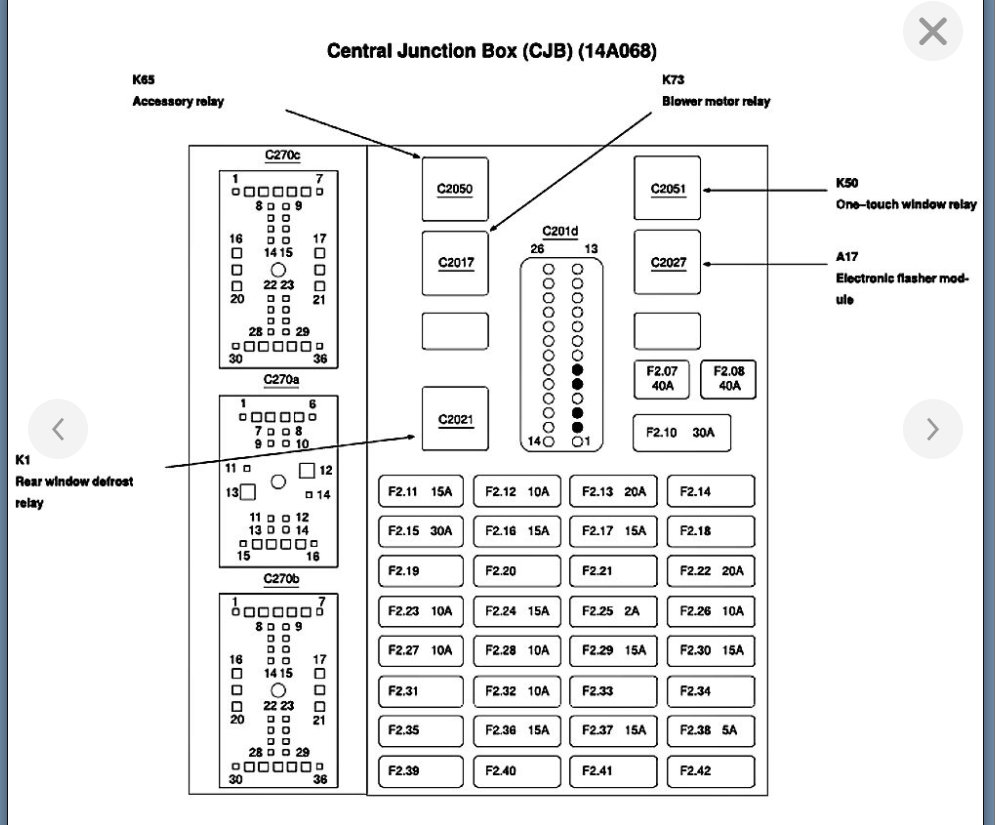

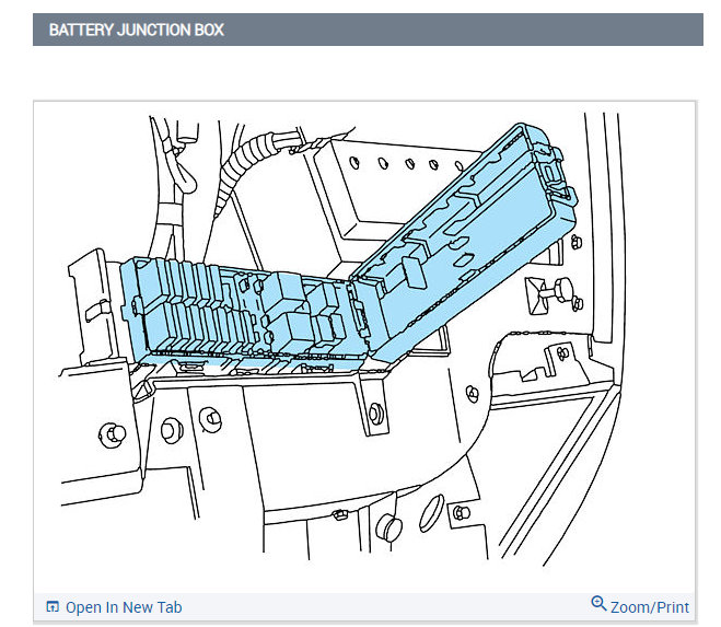

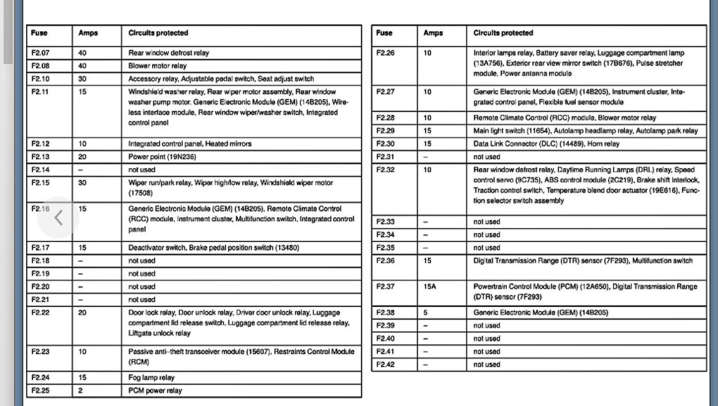

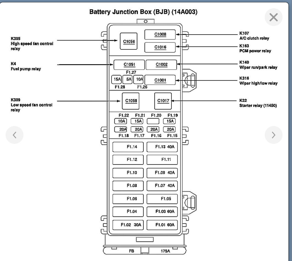

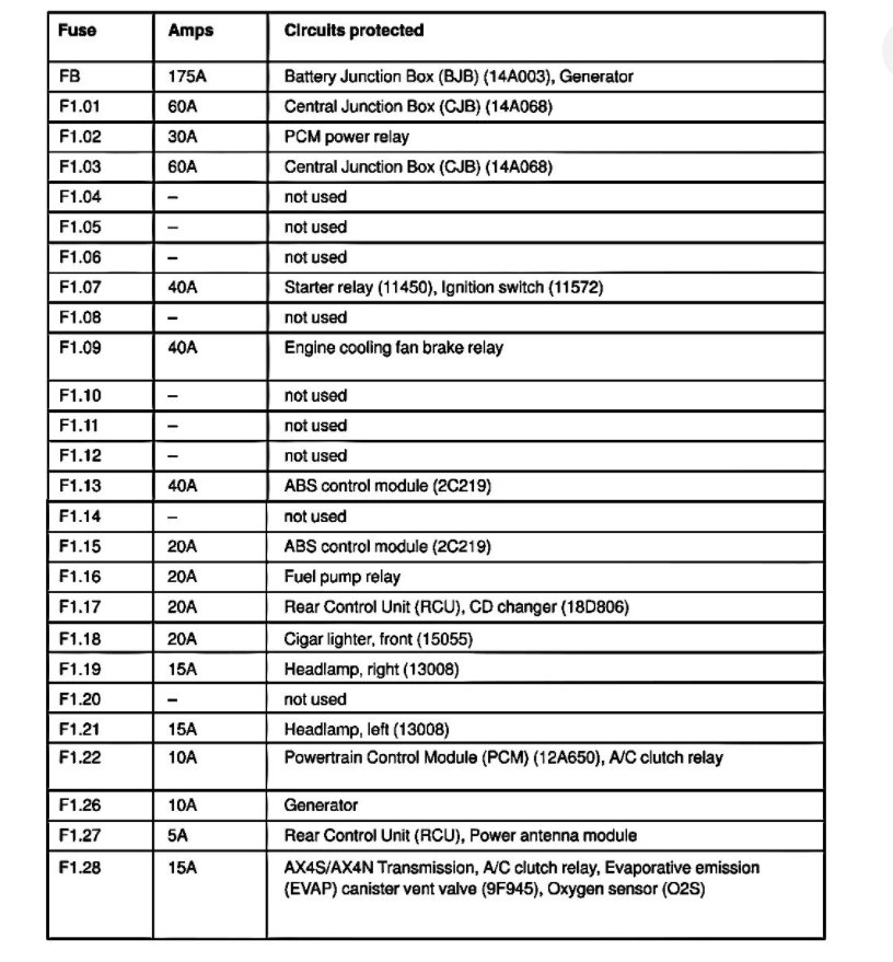

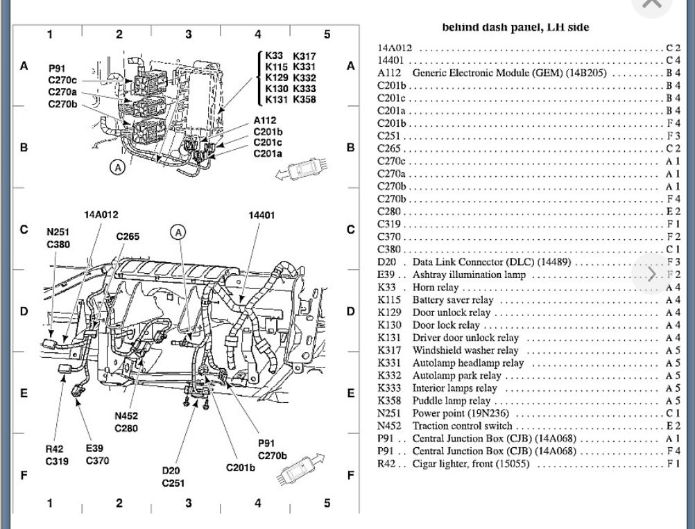

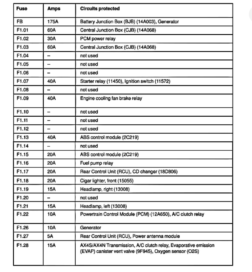

Dash board lights and console lights are out. We can't find the blown fuses. Can you tell me which ones to replace. Where are they on the fuse panel.
Thanks
Nov 19, 2008 at 5:06 PM
  • CAR REPAIR CONTRIBUTOR
I am going to attach all the fuse info that you will need for this vehicle.
Also, here is a guide that will help with testing and replacing fuses in case you need this info as well:
Below you will find the info from the manual on the fuses. Please let us know what other info you need. Thanks
