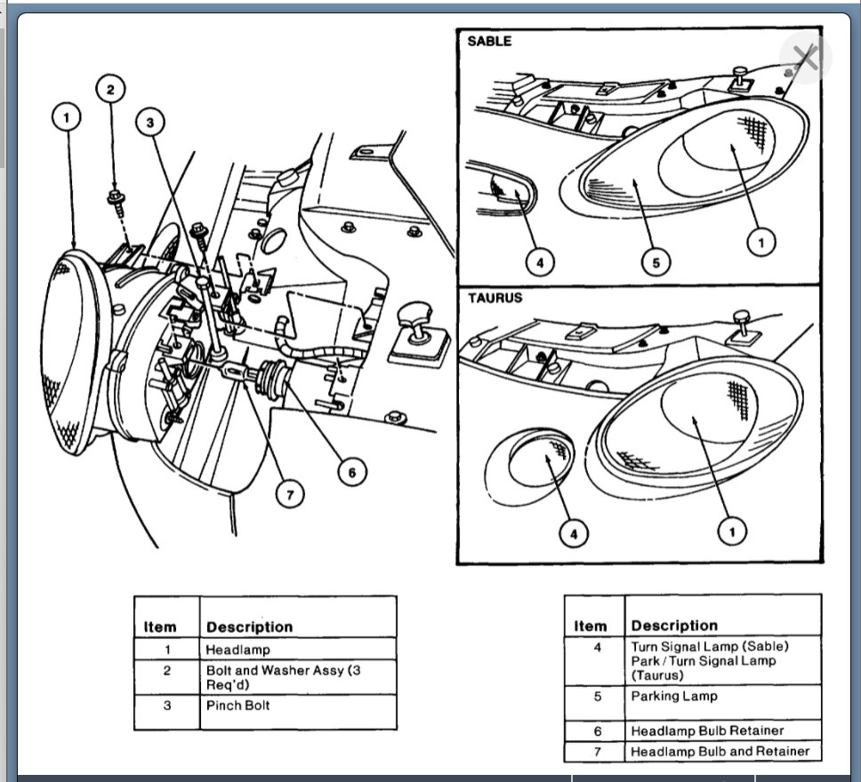

Just not sure how to access the front turn signal bulbs.
Wednesday, October 21st, 2009 AT 7:43 PM

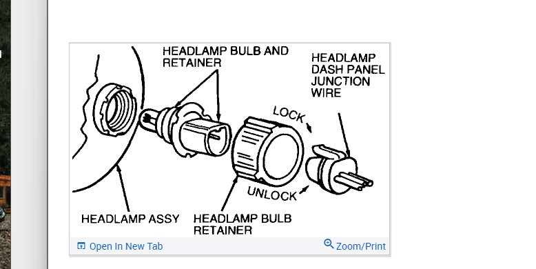

You are going to access these from under the hood. However, they are going to be behind a panel that you will see from under the hood.
I am attaching some documents that will help with this.
