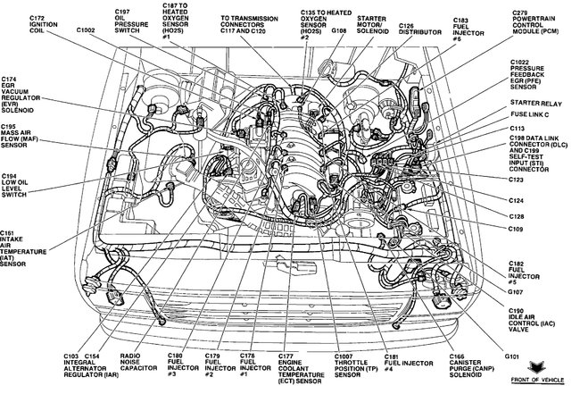

truck was running strong then developed a shake at idle until it stalls. Replaced the wires and plugs but no difference. Seems like a vacuum or something. I don't know these motors well but I'm open to suggestions is there an idler control?

Hi lsc14006, Welcome to 2carpros and TY for the donation Clean out the idle air control valve and also clean the MAF sensor with an electronic cleaner and see what happens

I cleaned up the Mass Airflow Sensor and replaced the IACV and it fixed the problem for a little while. Then it came back "very rough idling." If I tap on the IACV it idles smoothly, Is it possible that I bought a bad IACV?

Could be try recleaning the passages and the valve again and see what happens-don't work replace it

Ken, Kept fooling with the ISC valve. Turns out that this was the source of the vacuum/ idle problem. Replaced ISC and it's working okay. Thanks for your help. Stretch
