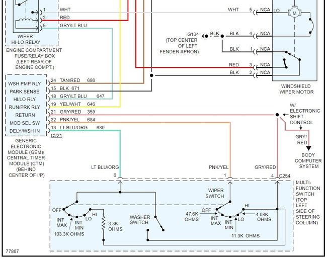

wipers quit Smelled something electrical cook. Replaced motor and burned out fuse. I have no power to new motor. Is there a relay somewhere that cooked? I unfortunately don't have an owners manual or schematic of system. Any help before it rains or snows would be great.

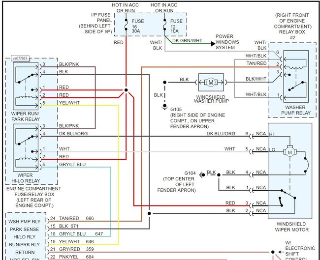

Wiper Hi-Lo Relay...In engine compartment fuse/relay box. Wiper Run/Park Relay...In engine compartment fuse/relay box.
https://images.2carpros.com/forum/automotive_pictures/266999_wiper_3.jpg
If you smelled burnt wiring, I would check where it goes into the steering column first, may have rubbed through Attached below are the wiring diagrams for your wipers

Start by using your owners’ manual. Find your windshield wiper fuse, look and see if it has blown. If that’s not the case, then use your owners’ manual to find your windshield wiper relay. Check that as well.

I have replaced the smart switch and have checked the fuses but the wipers only work spasmatically. I have been playing with wires under the hood and it seems to have helped some but when I crank it up they quit working for a bit

Did you replace the wiper switch on the column? It is a known issue with these trucks.
