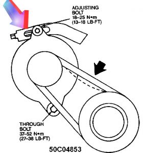

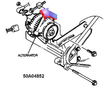

I have an 89 Ford Probe and want to put on a alternator belt what do I loosen and how do I do it!
Thursday, March 6th, 2008 AT 7:40 PM
SERVICE WRITER
MECHANIC
9,123 POSTS
You need to loosen up the adjuster, pull off and replace the belt, tight back up aon the adjuster.
