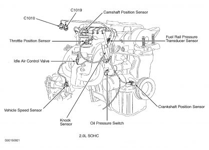

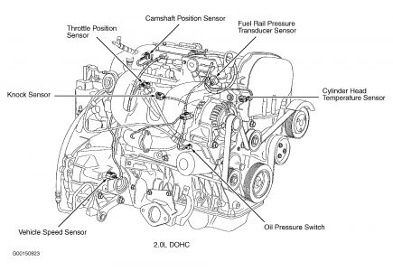

were is the sensor for the speedo
Tuesday, January 20th, 2009 AT 6:53 AM
DAVE H
MECHANIC
13,383 POSTS
Vehicle Speed Sensor (2.0L DOHC)On rear of transmission. See Fig. 4 .
Vehicle Speed Sensor (2.0L SOHC)On rear of transmission.
4) DOHC engine
