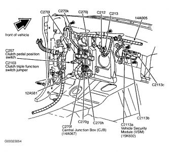

On my 2004 f250 the door chime headlight chime radio shutoff are all not working any suggestions?

Check fuse # 41 (10 amp) in the central junction box. The CJB is located under the driver's side of instrument panel.

If it is not the fuse what else can I try?

If it isn't the fuse then there is most likely some wiring that is damaged or loose behind the door panel.
