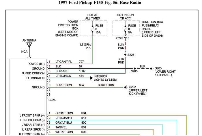

Six cylinder two wheel drive automatic.
My deck has four wires; red, black, yellow, blue. I have all the speakers hooked up correctly but the deck only gets power if I twist the red and yellow wires together and and hook them to the black/pink wire on my truck (accessories). My problem is I cannot seem to find the battery constant wire. How to connect the deck properly?
May 4, 2010 at 4:49 PM
BLUELIGHTNIN6
  • CAR REPAIR CONTRIBUTOR
  • 16,542 POSTS
Here are the full radio wiring diagrams for each radio that came in that tuck and a guide to help you test the connections with a video of the radio being installed:
and
https://youtu.be/jF_sDSS0n7I
May 4, 2010 at 4:54 PM
CT_TAZ23
  • 6 POSTS
Thanks. That is the best diagram I have seen yet, but I still cannot find that battery constant. I even tested the remaining wires with a multi-meter with the key out and still no luck. So I was wondering if I could use a bit of heavier wire straight from the positive side of the battery back through the firewall?

Try hooking your yellow wire to the trucks cigar lighter. That should work. Your stock radio may not have been wired to remain on with key off.
May 4, 2010 at 10:09 PM
CT_TAZ23
  • 6 POSTS
Will I still have use of that lighter socket?
May 4, 2010 at 10:19 PM
CT_TAZ23
  • 6 POSTS
Yes, I could still check the the time on it and set the clock and my presets would remain.
May 4, 2010 at 10:21 PM
BLUELIGHTNIN6
  • 16,542 POSTS
Okay, just wondering because my truck does not work if I remove key.
Anyways, yes do not remove the wire from the lighter, just splice into it and the lighter will still work fine.

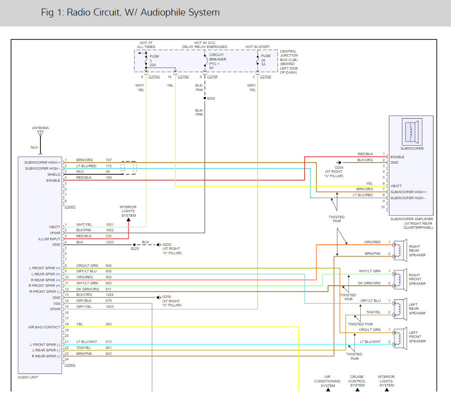

KHLOW2008
  • 41,814 POSTS
Here is a schematic of the radio circuit. I cannot seem to find some of the colors you have indicated.
Jan 3, 2017 at 12:37 PM (Merged)

Installed a dual XDM6350 radio using wire harnesses. If I hook up the radio illumination wire (solid orange) to constant power the radio works if lights are off. If I hook the wire to switched power, it only works when lights are on, tried every combination I can think of but cannot seem to get constant power no matter what. Also, when orange is hooked to the constant, I have no dash lights. Any suggestions?
KHLOW2008
  • 41,814 POSTS
Hi Page13, Thank you for the donation. What is your original radio specs, base or premium (with amplifier)? From both types of radio wiring schematics, I am not able to find any solid orange wire. Do you have the wiring schematics for the new radio that you have installed?
https://images.2carpros.com/forum/automotive_pictures/192750_RadioWiring94F150Fig57a_1.jpg
https://images.2carpros.com/forum/automotive_pictures/192750_RadioWiring94F150Fig58a_1.jpg
