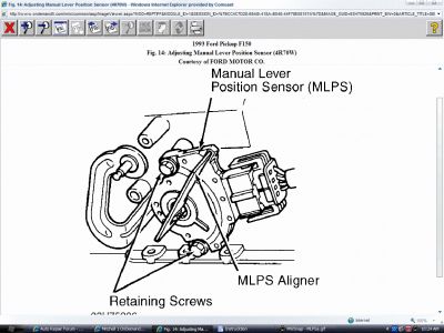

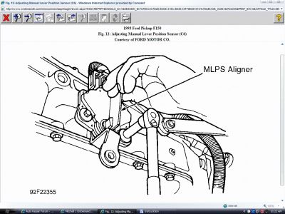

Where is the neutral safety switch and how do I change it
Saturday, May 17th, 2008 AT 6:50 AM
MERLIN2021
MECHANIC
17,250 POSTS
If you want the manual lever position sensor? Here are the two I show for your year, top is C6 bottom is 4R70W trans...you need the aligner tool...
On the side of the tranny...
