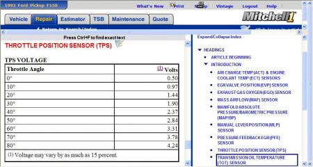

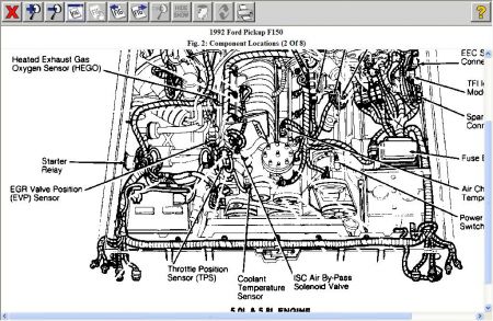

I was wondering where the TP Sensor is located on the throttle body, and if any tools are required to mount it properly.

See below
