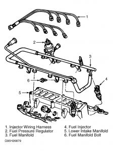

besides the 2 seals on the injector, do I also install one in the injector holder?
Thursday, November 13th, 2008 AT 3:01 PM
DAVE H
MECHANIC
13,383 POSTS
There should be an O ring at top of injector into fuel rail and at the bottom into manifold ??
