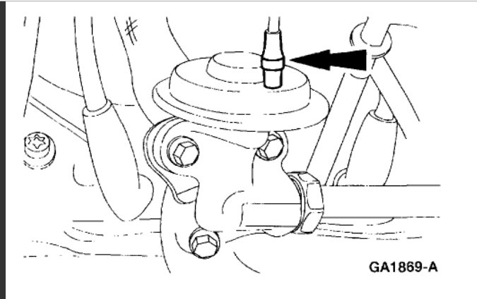

Will not idle after revving up. idles at 650 rpm at start up fine. Replaced IAC and no change. Cleaned throttle body and sprayed all hoses with carburetor cleaner and could not find any leaks. Only will not return to idle after getting to 1500 rpm's.

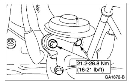

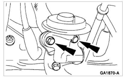

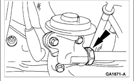

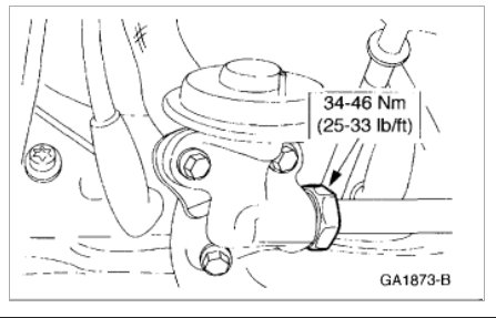

It sounds like you could have a EGR valve stuck open or the vacuum supply is not cutting off. Here is a guide so you can see what the valve is and a video on how to test it.
https://youtu.be/DqUCbbKdWf4
and
https://www.2carpros.com/articles/engine-idles-too-high
(Here are the diagrams Below)

Turns out it was the TPS. It was at .88v and adjusted it to .98v and now running good.
