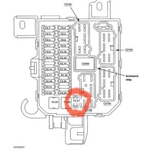

My Escape had to be jumped the other day. Since then the radio, dome light and locks do not work. I changed the relay fuse that works for all of them, but it did not help.

Replace fuse # 27
If I understood your PM, you replaced the relay.
