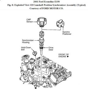

Where is the cam position sensor located on a 2001 E-150? Thanks

Got a code for a camshaft postion sensor? When you pull off the sensor, plan on finding the top of the CPA syncronizer shaft torn up.
