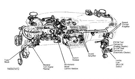

Please tell me where the inertia switch is located
Sunday, December 28th, 2008 AT 4:58 AM
DAVE H
MECHANIC
13,383 POSTS
Inertia Fuel Shut-Off Switch......Behind right kick panel. See Fig. 5 .
