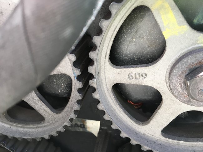

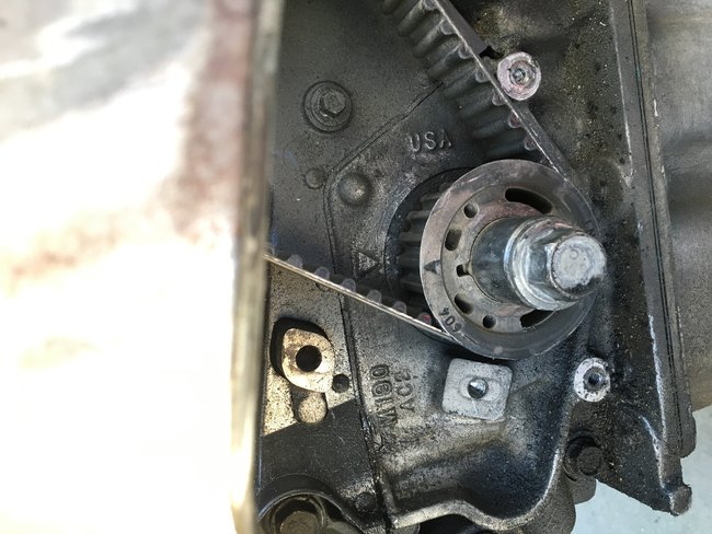

Car has a cylinder misfire. Was originally cylinder three. Replaced spark plugs, wires and replaced coil pack with a known working coil pack with no change. Other then cylinder three misfire has moved to cylinder two. I do not understand why cylinder three went away and now it is cylinder two. Tested compression and all four cylinders are 190 PSI. Thought maybe the timing belt stretched a tooth. Took pictures but it looks like it is in time but I could be wrong. Does not have a misfire in fourth gear. Only in fifth gear and it starts when you get to forty five to fifty mph.
Jul 29, 2020 at 12:02 PM (Merged)
MHPAUTOS
  • CAR REPAIR CONTRIBUTOR
  • 31,937 POSTS
Valve timing looks okay, have you checked for any vacuum leaks at the inlet manifolds yet?
GREENCHEVYMALIBU
  • 230 POSTS
Yea, I sprayed intake cleaner around the intake and it does not change the rpm's.
MHPAUTOS
  • 31,937 POSTS
You say the coil is known good. i would still suspect an electrical issue as with engine speed compression pressure increases considerably and a problem with the ignition system will be the first thing that is compromised. basically electricity is lazy, as the cylinder pressure increases, the spark has to work harder to jump the plug gap and ignite the mixture, if there is a path to earth that is of less resistance it will go that way. basically that is what an electrical misfire is, a short to an easy earth under pressure. fuel issues often are there all the time, probably a live data read with a high end scanner will show electrical activity that will indicate a short/misfire in the ignition system.
GREENCHEVYMALIBU
  • 230 POSTS
Yea, I swapped the coil from my Neon to my mother’s Neon and her Neon drives with no problems. I will swap the coil and plug wires from her Neon to mine and see what happens.
