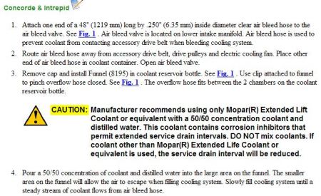

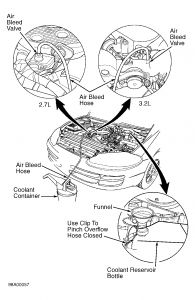

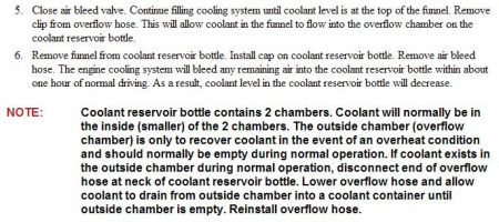

How do I bleed the cooling system
Friday, September 4th, 2009 AT 10:05 PM
BLUELIGHTNIN6
MECHANIC
16,542 POSTS
FIG. 3
