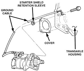

whats the easiest way to take off and put back on a starter without dropping the transmission?

1. Disconnect the negative battery cable. Raise and safely support the front of the vehicle on jackstands 2. Remove the three bolts attaching the starter to the engine/transaxle. Remove the three mounting bolts
https://images.2carpros.com/forum/automotive_pictures/103836_start_1_1.jpg
3. Remove the starter from the transmission housing. Position the starter to gain access to the wiring connectors 4. Remove the battery positive cable nut from the starter and remove the cable. Remove positive cable
https://images.2carpros.com/forum/automotive_pictures/103836_start_2_1.jpg
5. Disconnect the push on solenoid connector 6. Remove starter Have a great New Year :D
