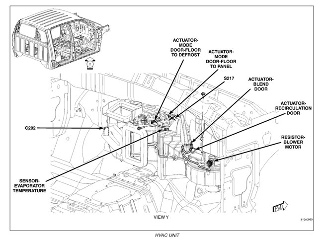

As I stated before, I have already checked the motor and it runs fine. I am getting full voltage at the blower motor plug regardless of the position of the switch. At the blower motor plug there is a green wire and a blue striped wire. The green wire has 12+ volts all the time. When checking with a volt meter across the 2 wires (with the plug disconnected) I get no voltage. With the plug attached to the motor, I grounded the blue striped wire and the motor ran fine. As I stated before, could this be a grounding circuit where the resistor/switch act as a variable ground? Would that mean that the resistor is somewhere between the motor and the switch on the ground side of the circuit? I still have no idea where the resistor would be located so that I could check it to see if it needs replacing.
Wednesday, October 29th, 2008 AT 7:00 PM
  • 108,355 POSTS
Hi Again:
Yes, the resister is between the motor and the switch. I just looked it up in the manual and the resister is on the passanger side interior under the dash. It is attached to the right side of the HVAC unit. If your not geting a ground through the wiring harness and have to run a seperate ground, the resister is the problem. Keep in mind, the switch redirects the 12 volts to different areas of the resister. Thus the resister is responsible for how much power the motor gets. See if you can find it. I think that is your problem.

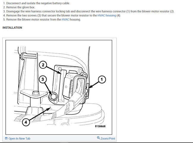

Hi my heater fan did not work on the low setting, but worked on the high setting, then didnt work at all.
I was told it could be the heater fan resiister Do you know where it is located?
Monday, January 18th, 2021 AT 9:26 AM (Merged)
CARADIODOC
  • 33,761 POSTS
Bolted to the heater box, near the fan, usually with a pair of 5/16" bolts.

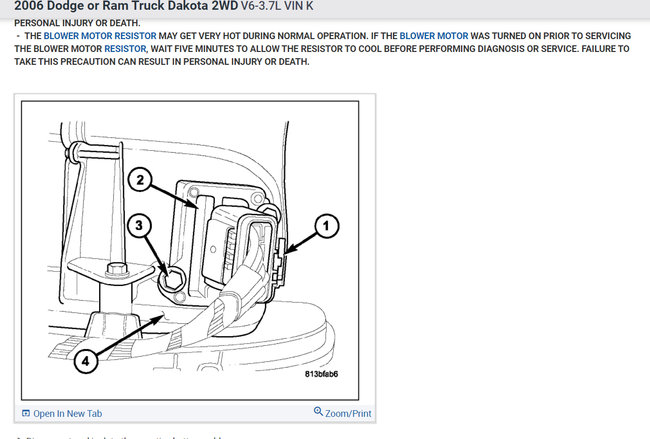

My heater only works on high spped, I was told I needed a new resistor, I am having trouble locating the spot in the vehicle where the resistor is located
ARMURIERDRP
The heater resistor card is located right under the glove box lower front left right over your left foot if you sit in the passenger seat you should see a 4 wire plugged into it. You need to remove 2 screws with a 1/4inch socket and you will have your resistor.

I cant find that little resistor coil (looks like a reastat) that is supposed to be on heater box under dash. Heater fan works on bench, relay good, fuses good, but heater fan works when it wants to.
  • 108,355 POSTS
It should be located on the heater box. Here is a picture of what you are looking for:
https://www.2carpros.com/forum/automotive_pictures/249084_2_3.jpg
Let me know if this helps.
