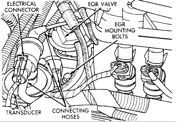

where is this part located on this vehicle.

EGR, EET Location
The Electronic EGR Transducer (EET) is mounted next to EGR valve, at rear of intake manifold.
