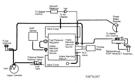

How are the vaccums routed on a 3.0 from the EGR to the air cleaner and the AIS. AND Does the AIS have constant vaccum?

Hi:
This is the only vacuum diagram that I could find. I hope it helps. Let me know.
