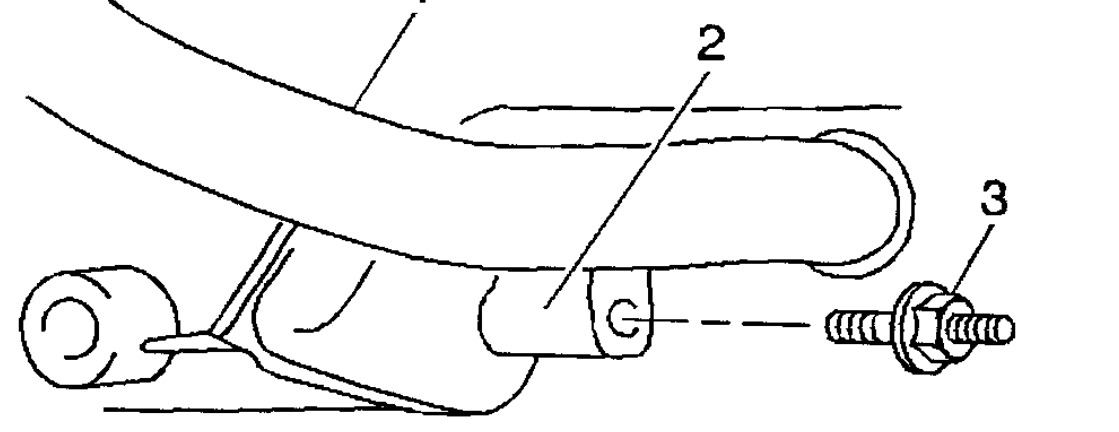

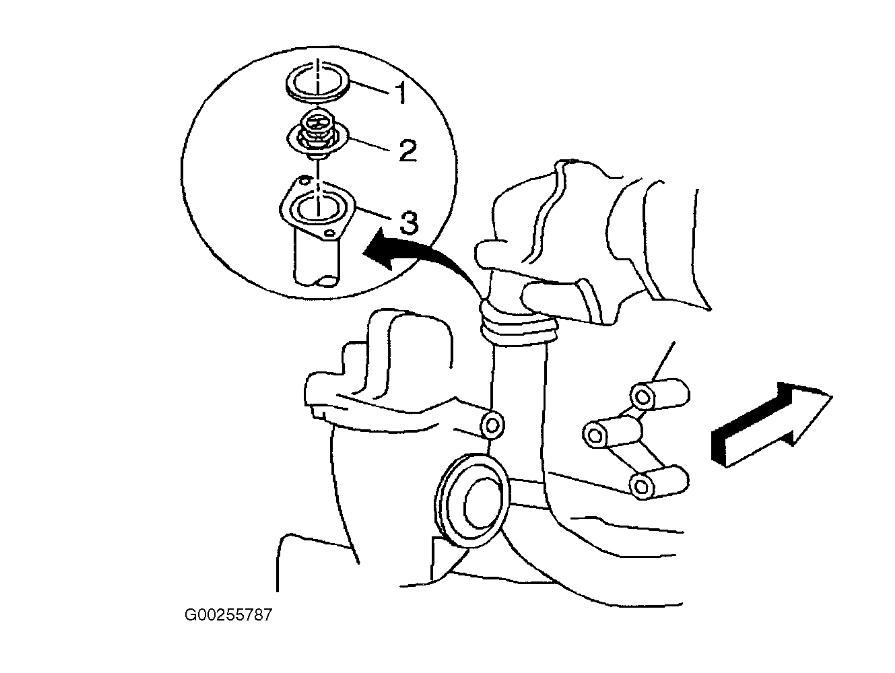

I had a mysterious coolant leak last year and it was tough to find.. I thought it was the water pump.. Turns out the threads on the surge tank fill spout were stripped and coolant was running out the overflow hose..
I've replaced that but since it has full pressure again the thermostat gasket is done.. I know where it is but need the best laid plan as how to GET to it. One bolt is nearly inaccessible.

remove exaust heate shield, remove coolant pipe housing bolts through manifold, remove collantpipe stud fromoilan remove tire and splash shield remove bolts form transaxle brace assy and brace remove coolant hsg pipe then remove tstat revers for reassy

remove exaust heat shield, remove coolant pipe housing bolts through manifold, remove coolant pipe stud from oil pan remove tire and splash shield remove bolts from transaxle brace assembly and brace. remove coolant housing pipe then remove thermostat. Reverse procedure for installation
Sep 21, 2020 at 10:17 AM
SNEAKFOX
Thank you very much.. You probably saved me an hour of unnecessary work!
