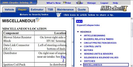

Hello guys,
The heater only works if I turn it all the way over to the full blast zone.
I smelt for antifreeze, and can't smell anything. Dont know whats goen on?
Its a 2000 Sebring convertable, with a V-6.
Wednesday, November 14th, 2007 AT 9:09 PM
MECHANIC
75,992 POSTS
Replace the blower motor resistor see below for location
