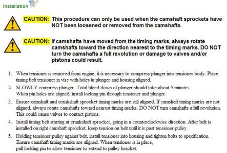

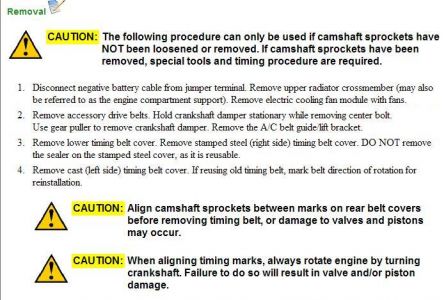

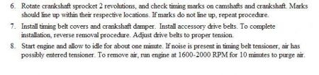

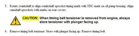

My timing belt has never been changed. The owner's manual says it should have been changed at 60,000 miles. I want to do it myself.
How do you replace a timing belt?
