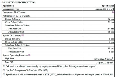

How much of an oil charge and which oil is in a 96 chevy 1500 truck A/C system with 5.0 liter engine?
Tuesday, September 18th, 2007 AT 5:05 PM
MERLIN2021
MECHANIC
17,250 POSTS
I come up with 8 oz...bone dry!
Uless U have a rear unit, then it's 11oz.
