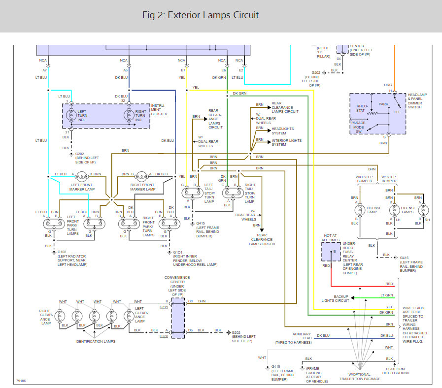

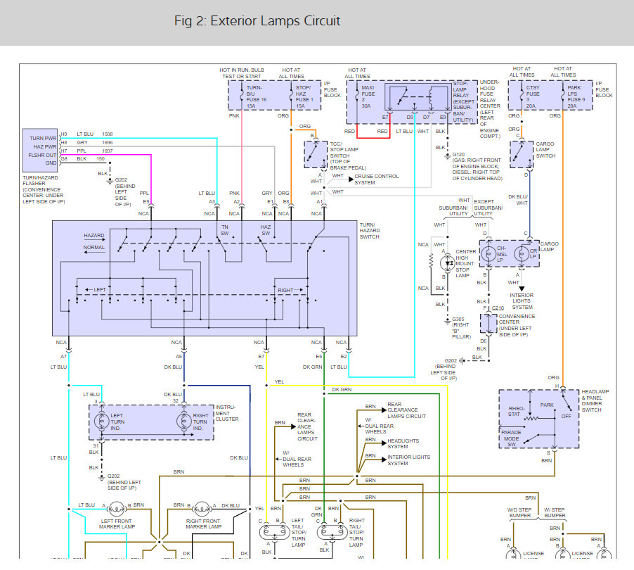

PEAR69
  • 1,482 POSTS
From the brake light switch the wiring goes to the hazzard then turn signal switch. Here is a wiring diagrams so you can see how the system works and a guide to help you test the connections:
