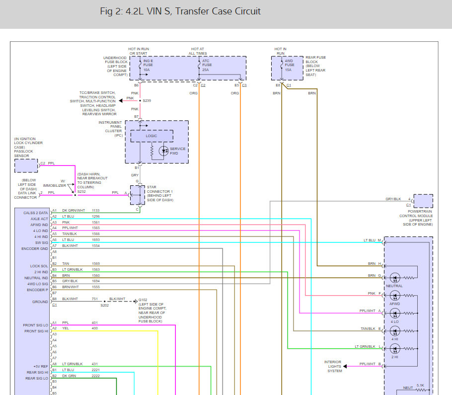

i have a 02 trailblazer with 4 wheel drive problems granted it frustrating me. i had a scanner hooked up to it and its not responding i replaced the switch then the dash lights went out and i check the fuses in the hood since i cant find any fuse box in the cab can some one else help me please cause i need the 4x4 for winter.
I checked the sensors and there is no power I checked all the fuses and they are fine. This is really making me mad
i got the dash lights back on so know all i have to worry about is this 4wd it seems like trailblazers have issues with 4wd problems i had a 99 chevy s10 zr2 and it had 4wd problems i think chevy needs to relook at this known problem and recall them all.
No there is no power to the actuator. I turn the new switch and nothing happens I checked the power to the actuator and there is no power at all. Fuses are good

There is three fuses that run the 4 wheel drive system. Here is the wiring diagrams so you can see how the system works I would test for power at the fuse and at the transfer case controller.

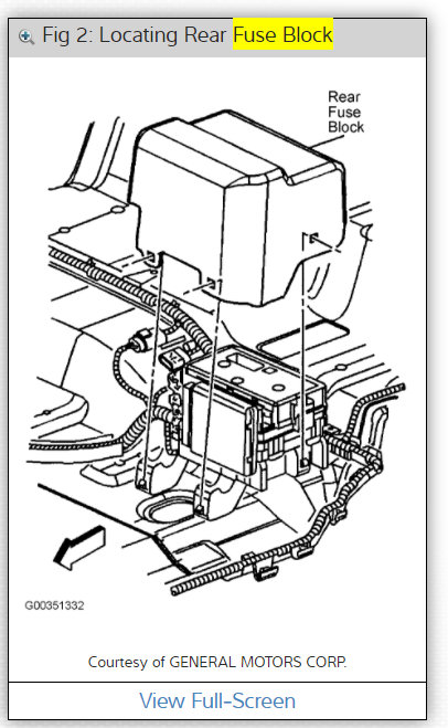

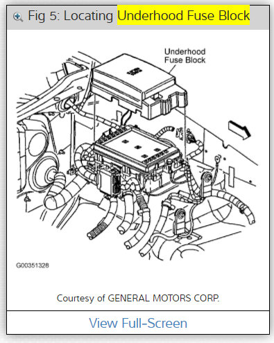

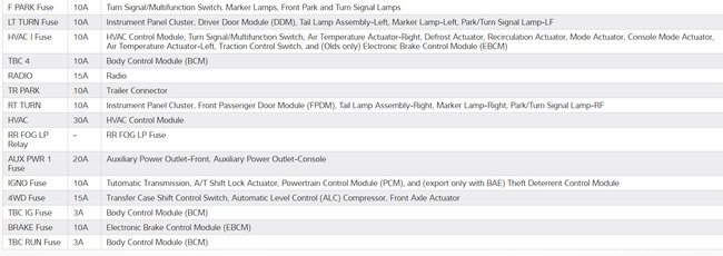

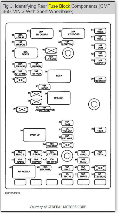

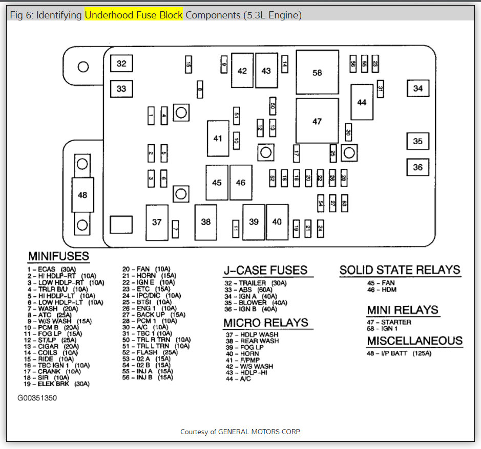

There is no power getting to the switch. I just looked at a schematic of the system. According to the schematic, there is a 15 amp fuse in the rear fuse block below the left rear seat. Did you check that? Also, under the hood at the fuse block, there is a black / white wire which is a ground. Check to see if it is in good condition.
I have attached a schematic. Even though you can enlarge it, I don't know if you will be able to read it. Let me know if you checked there for the fuse.

the fuse is good in the rear and same with the ground wire no corrosion still nothing. i do really thank you for helping me through this. i wish i had a car lift make it easier to get under it instead of jacking it up then climing under it lol.

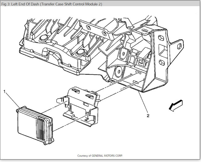

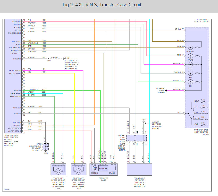

Not a problem. Let me know what you find. It sounds like the transfer case controller is out here is its location tey a used one.
Dec 14, 2010 at 7:17 PM
COOKJD2610
  • 6 POSTS
Thanks for the tip I got s used one from my buddy who has a bunch of parts for these cars and it worked! I am ready for the snow. :) thanks again

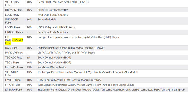

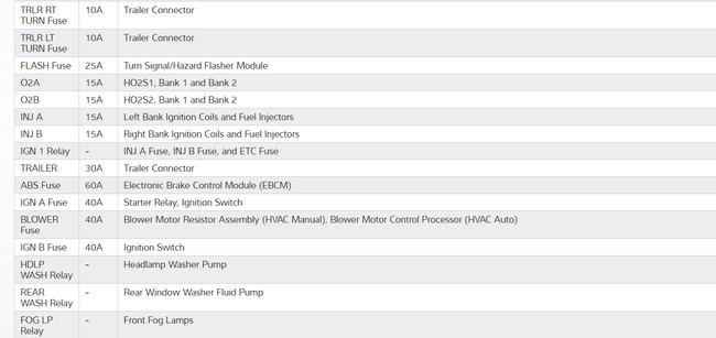

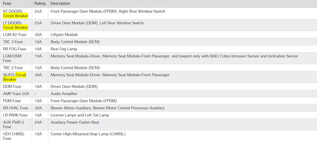

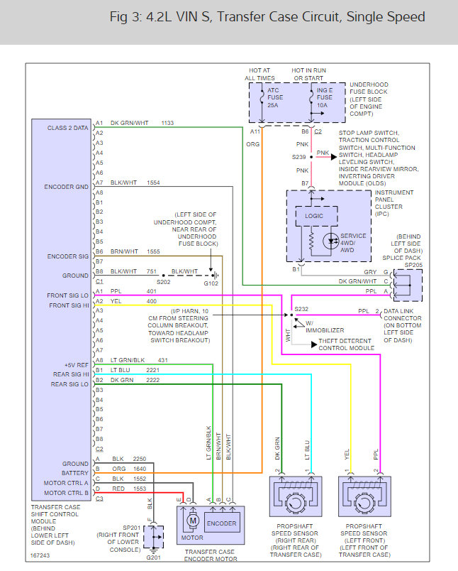

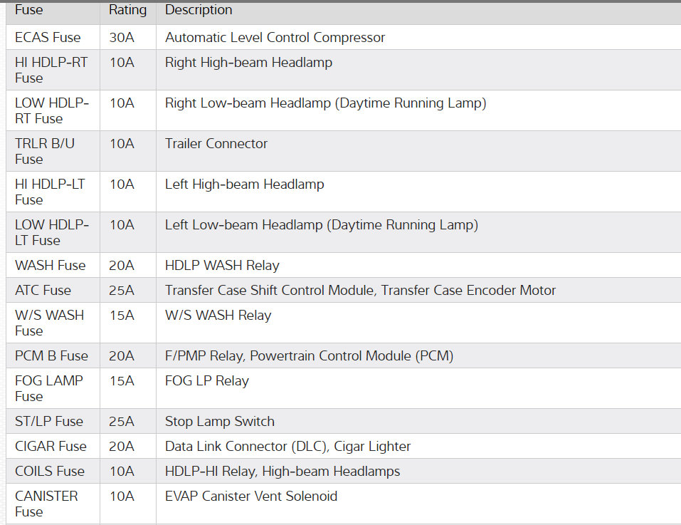

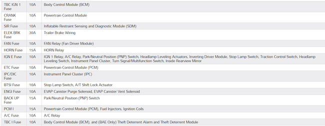

There are two fuses (ATC and IGN1 under hood fuse panel) we must check for power. here is a guide to help us get started and the fuse locations along with the transfer case wiring diagrams so you can see how it works below:
