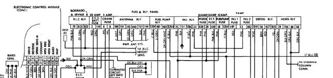

Ok thanks for the help on the ac it is fixed.Now I have another question for you. I have this 1981 cad sedan de ville getting no fuel to engine my manual does not show anything I need to know inside the cat it has 2 fuse boxes one of them holds the relays do you happen to know which one might be the fuel pump relay?It has a 6.0 8,6,4 motor DFI system.
Jul 28, 2019 at 7:02 PM (Merged)

HMAC300
  • CAR REPAIR CONTRIBUTOR
  • 48,601 POSTS
boy you surelike punishment with that motor lol. see pic
