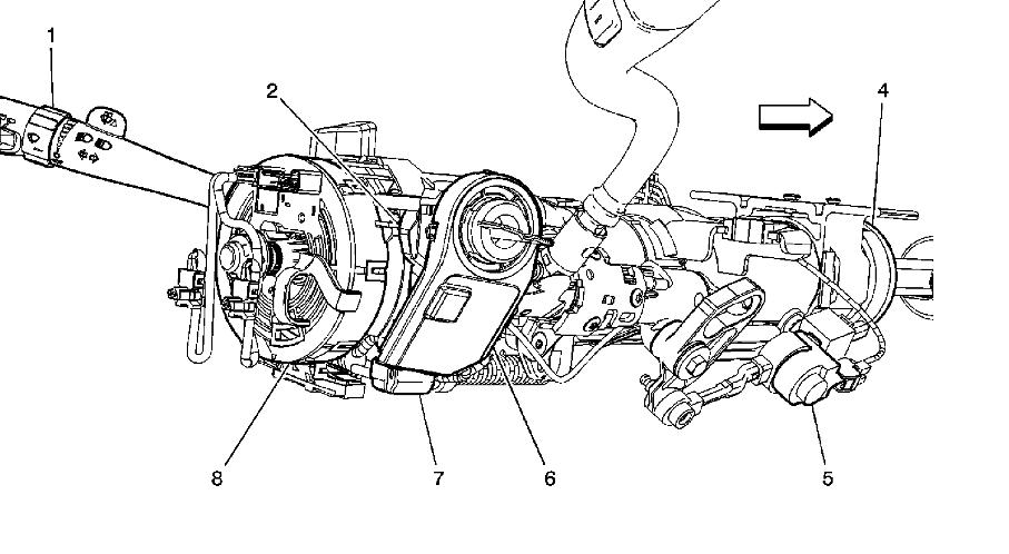

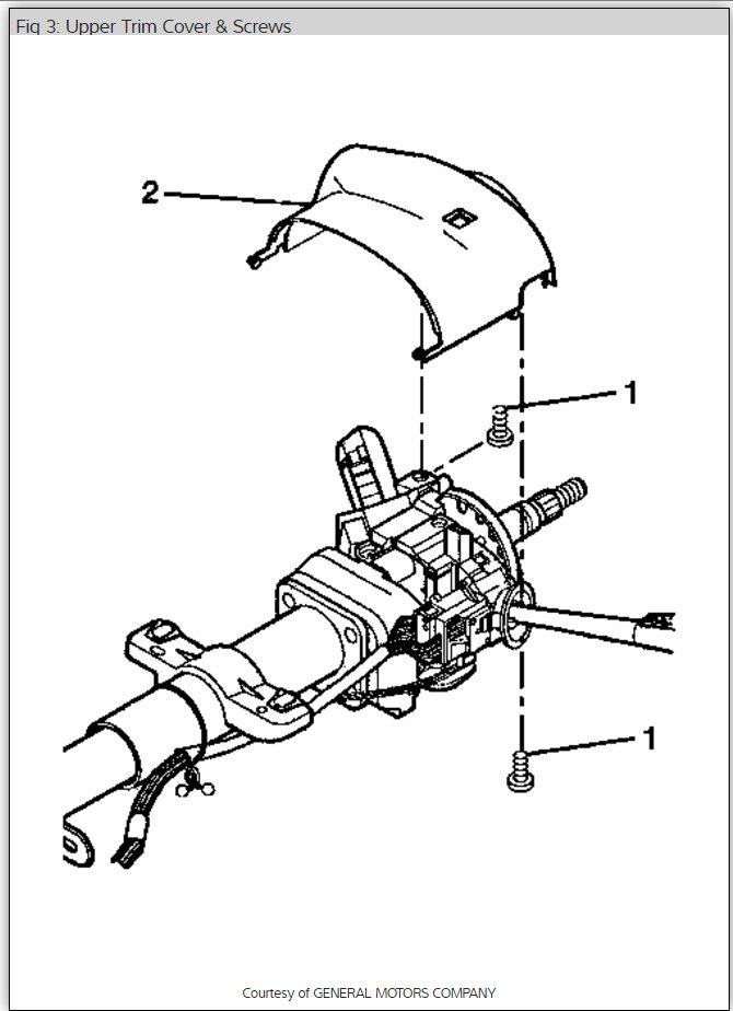

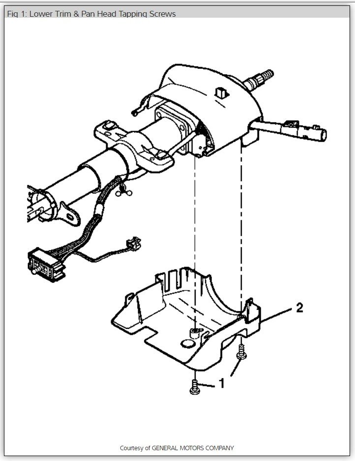

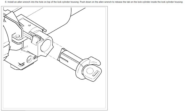

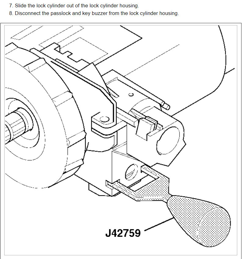

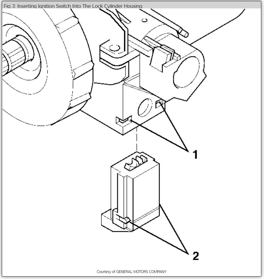

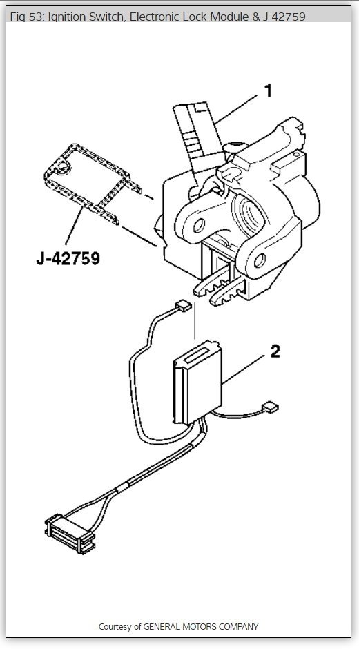

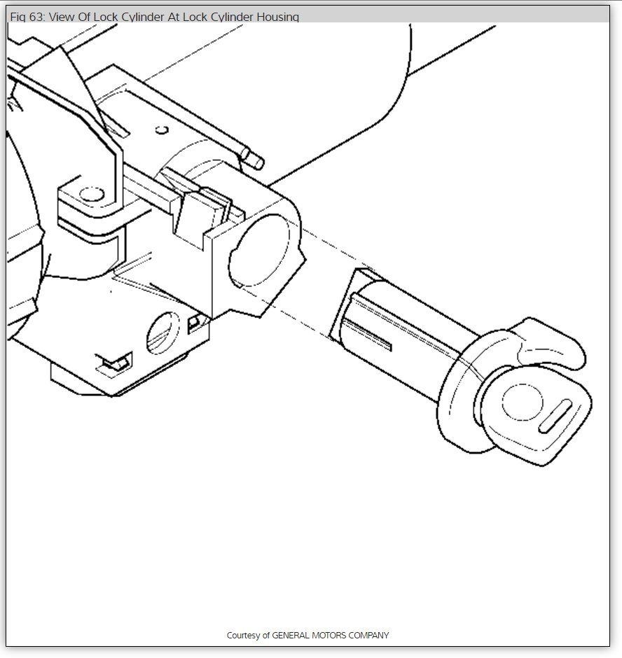

When I started the Suburban and shifted into drive, the gear indicator line did not move and the speedometer did not work. I turned it off and restarted, the gear indicator line was not there and the speedo still did not move and the airbag light was on. I took it to Autozone and the only code that was pulled was from the history and it was for a TPS. After plugging the diagnostic reader up to the Suburban it was fine and everything operated normally. Driving down the road and the parking brake light came on. Turned it off and restarted it was fine. Took it to the dealership today and they said that I have a faulty ignition switch and want to charge me $165. My question is when I do a search on the internet two parts come up and they are a module and the lock cylinder, which one is the dealership talking about? Each are about $40 and would this be feasible for me to change out, do I need any specialty tools?
Thanks ahead of time,
Gus
Dec 19, 2013 at 11:46 AM
HMAC300
  • CAR REPAIR CONTRIBUTOR
  • 48,601 POSTS

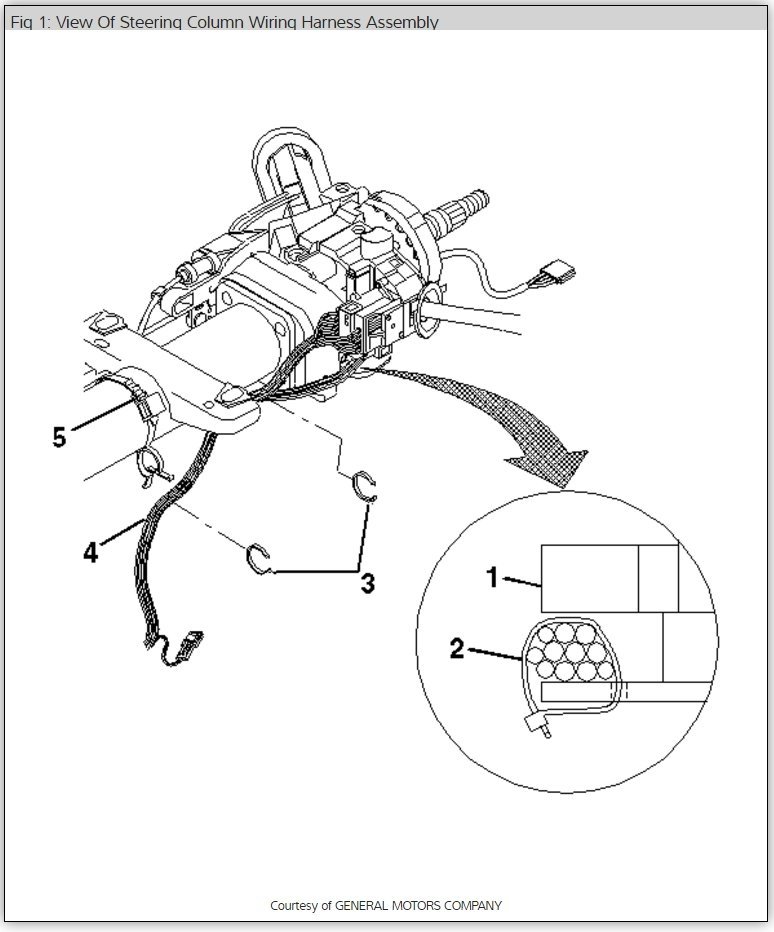

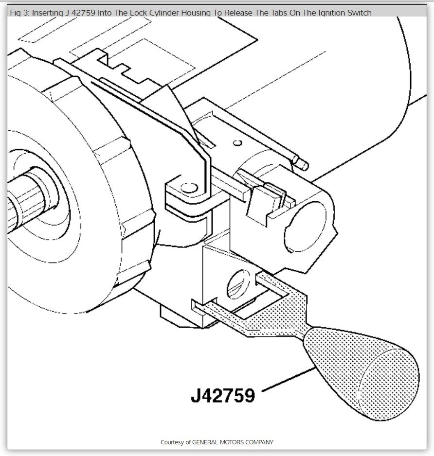

item 7 in pic the module. Here are the instructions on how to replace the ignition key and tumbler for you car in the diagrams below. Check out the diagrams (Below). Please let us know if you need anything else to get the problem fixed.
Dec 19, 2013 at 1:22 PM
GUSTAFA75
  • 21 POSTS
Sorry for the late reply but that was exactly the problem. Thanks for the help!

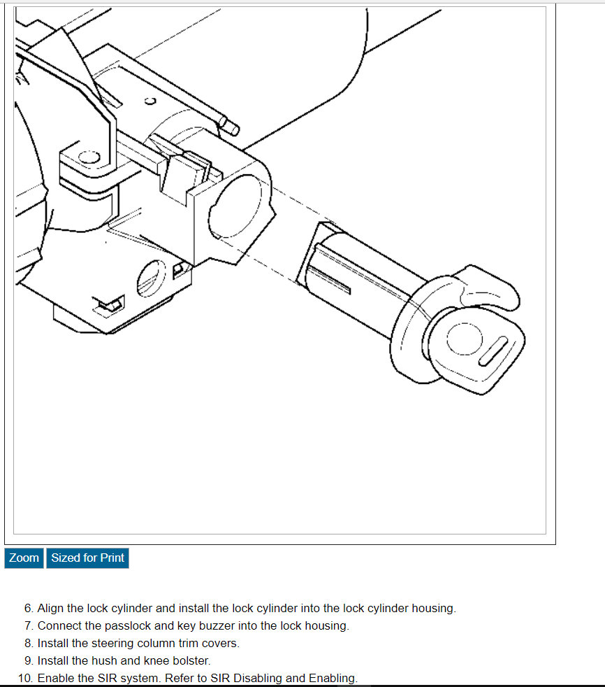

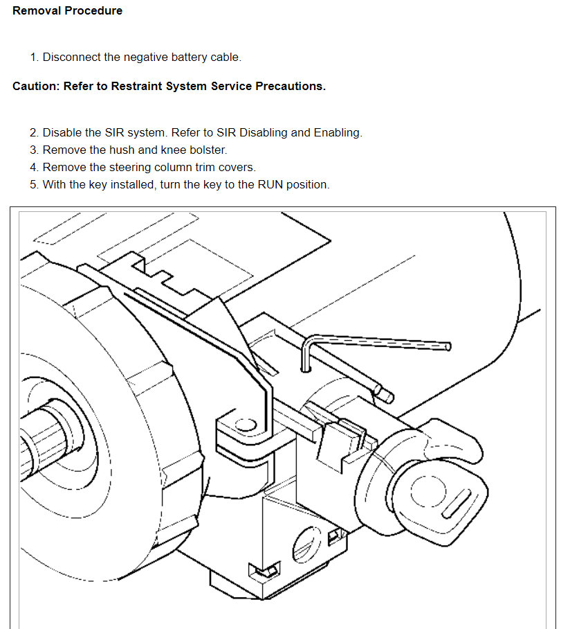

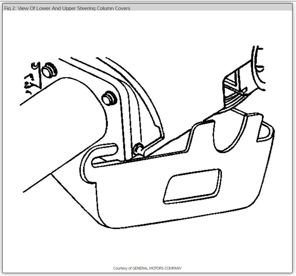

My key does not turn in the ignition however the steering wheel is not locked. I plan to replace the ignition key tumbler assembly. Can you tell me how to remove and replace the assembly. I'm hoping I dont have to pull the steering wheel.

BLUELIGHTNIN6
  • 16,542 POSTS
https://images.2carpros.com/forum/automotive_pictures/261618_Noname_1015.jpg
https://images.2carpros.com/forum/automotive_pictures/261618_Noname2_287.jpg
https://images.2carpros.com/forum/automotive_pictures/261618_Noname3_108.jpg

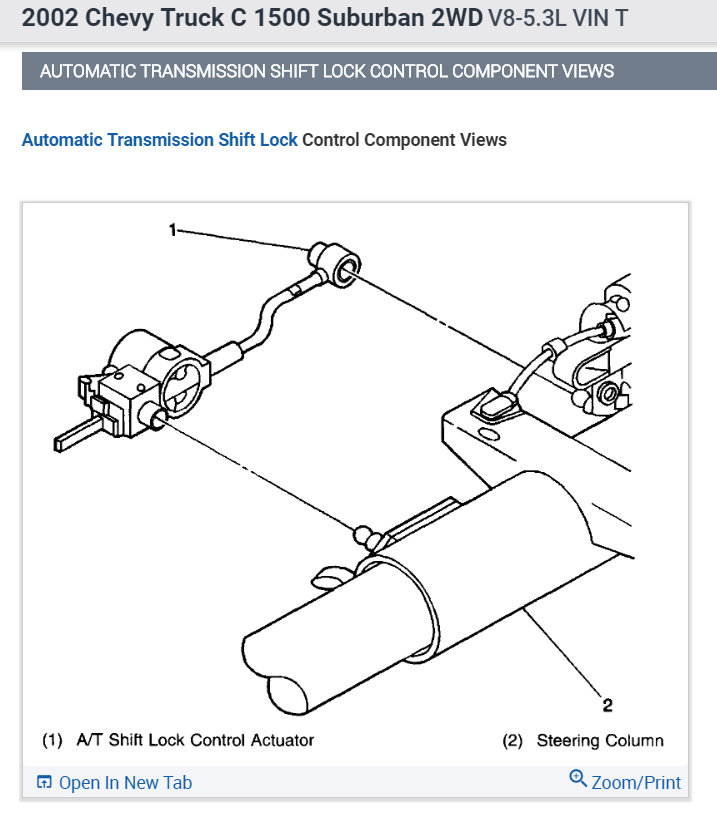

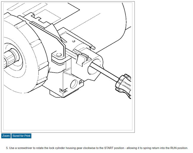

JAAZIEL HAMPTON PICKEL

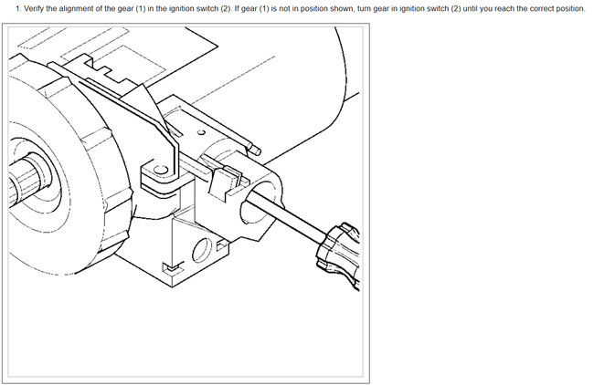

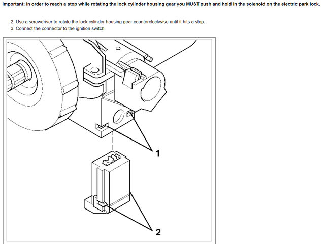

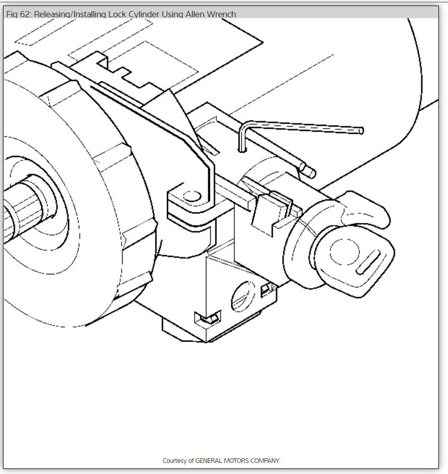

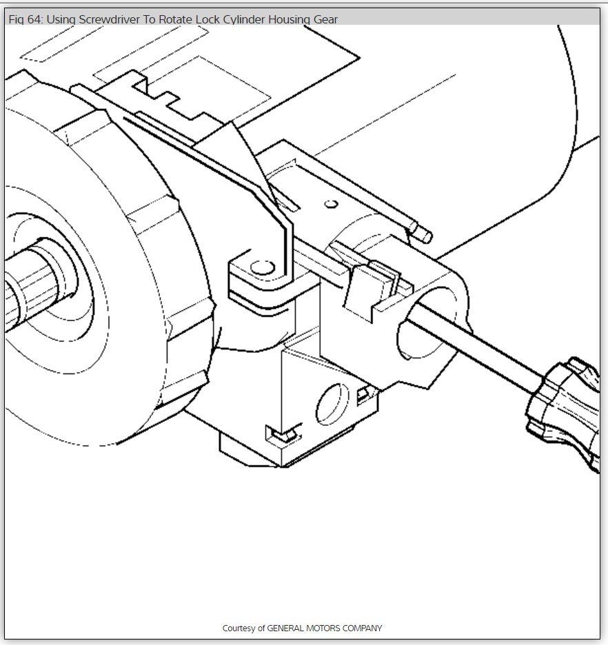

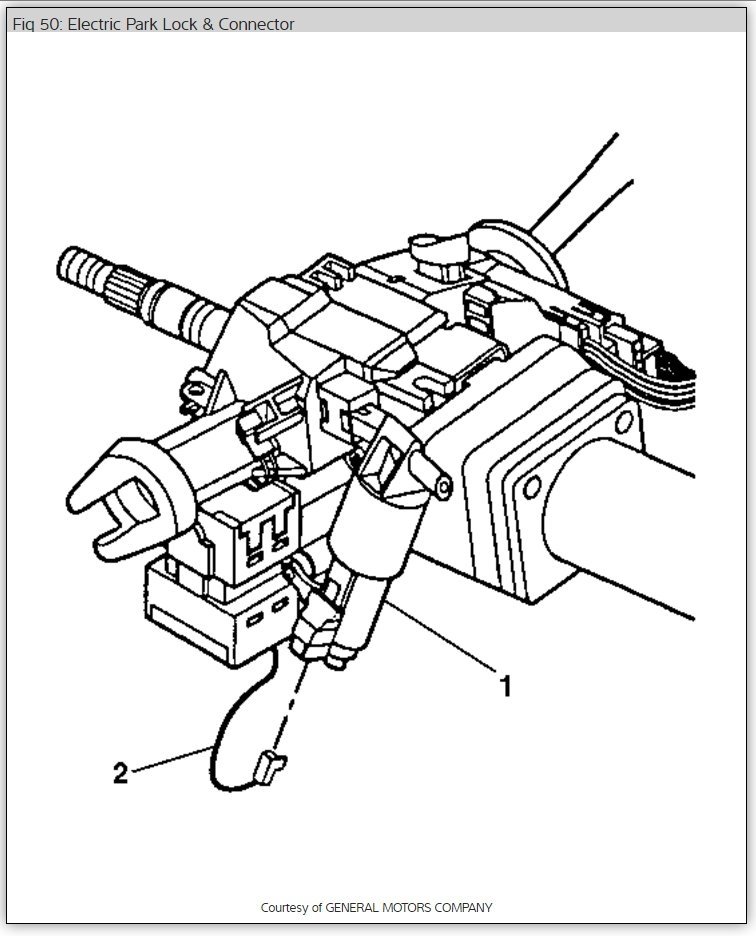

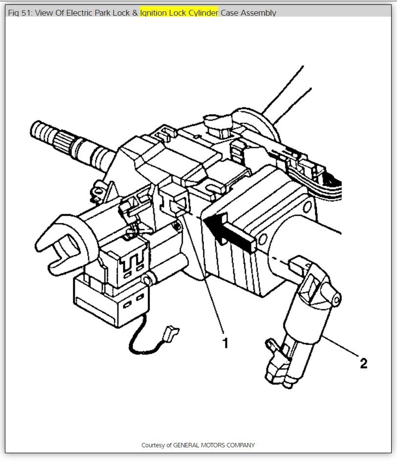

My old lock cylinder was not allowing the key to be turned to lock to release the key. We got new cylinder and it works outside just fine. Second it is installed we can turn it to start and run but still will not turn to lock and release the key. Help!
Sep 19, 2020 at 5:04 PM (Merged)
  • 54,350 POSTS
Two things come to mind first is the ignition switch is locked up or the interlock solenoid is not working not allowing the key to be fully turned off. Here are diagrams to help you see what I am talking about. Try to turn the switch with the key out. Use a screwdriver to work the switch.

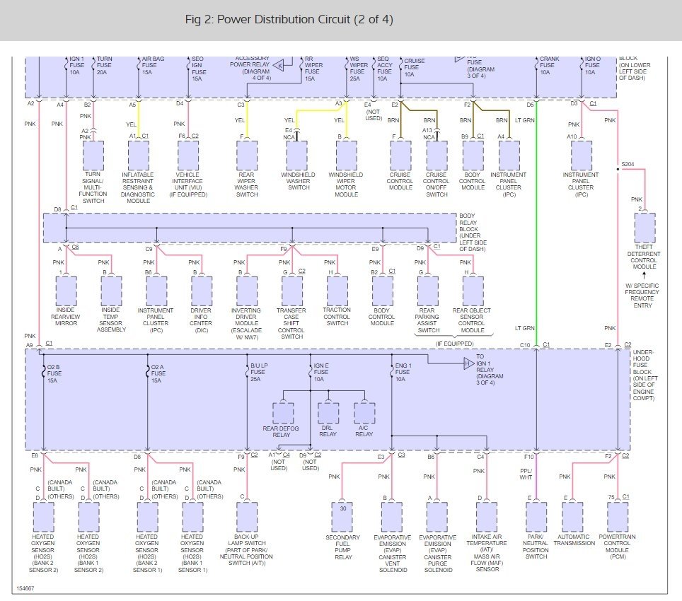

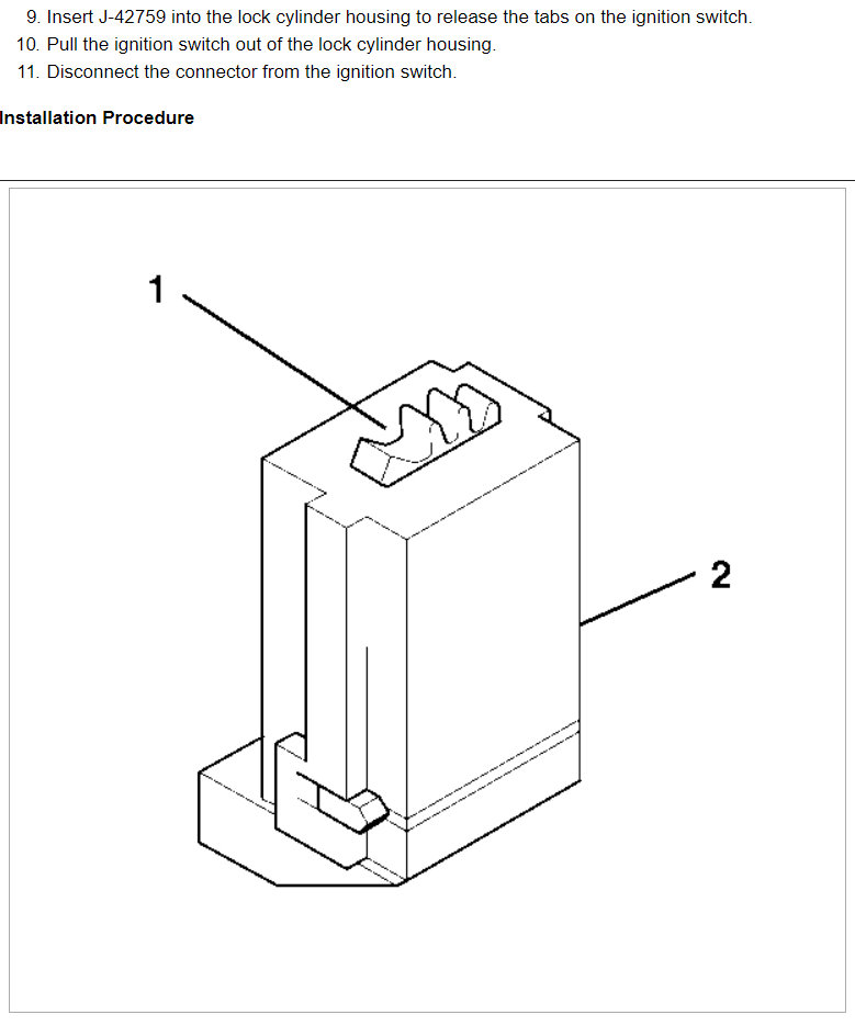

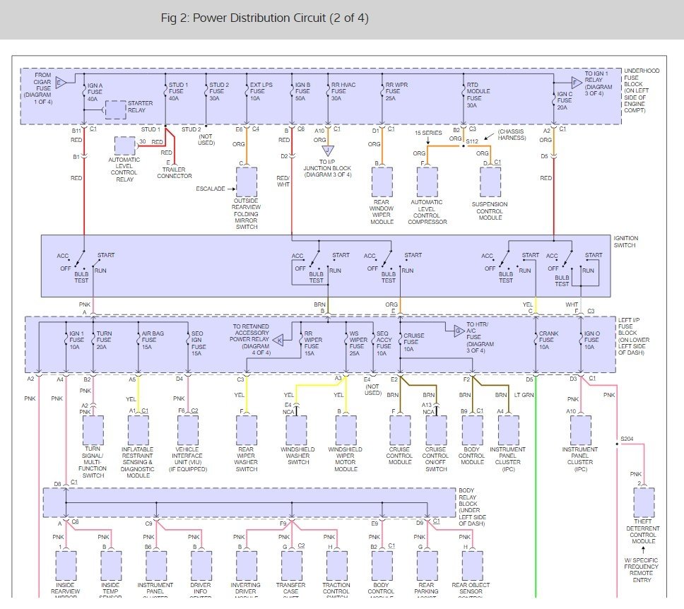

ANGELO159
Due to a leaking windshield, water had gotten the steering column wet. A few times. Not sure how bad. Looks to have been a few drops that splatter on the top cover.
my problem is that the right blinker, brake lights, ignition (accessories), cruise control are all not working properly.
The left blinker, windshield wipers (all functions), brights, horn all work fine.
The right blinker works but it will stay on. No blinking go on, only when I manually control it. Also, a noise coming from around fuse panel area will make a buzz sound when I use the right blinker. The brake lights are on the entire time while driving or in park. Here the kicker though; if I keep my foot on brake pedal and then take keys out of ignition, the car will stay running until I take my foot off the brake pedal. Then it will turn off. But when it is off i can push the brake pedal and car acts like the key is in and turn to "on" (radio, dash lights, air will all turn on) without keys even in the truck.
Today I thought I would mess with it. I took covers off the steering column. Proceeded to look around the ignition area. Disconnected to top three wires above ignition. Then reconnected it. I do not why but it worked! No more problem blinkers all work. Brake pedal does not turn car on. And brake lights worked normally. So I celebrate quickly and go to put the cover on carefully. And just as i got the top half on. I tested it again. And it went back to acting up. Bummer.
So taking the cover off i tinker more. And found out that if I either have the hazards on, or the right blinker on the brake will not turn the car on. maybe extra resistance in the circuit may play a factor. I do not know. think it might be running through my blinker into my brake. So yeah any help or direction would be awesome.
I looked up a couple things and it led me here. So I thought I would throw this out there and see what I get. Thanks.
  • 54,350 POSTS
It sounds like you have an ignitions witch that is shorting out. Here is some diagrams that will help you get the switch changed out.
Also I have some wiring diagrams and a guide to help you do some testing.
and
Please run some tests and get back to us so we can continue helping you.

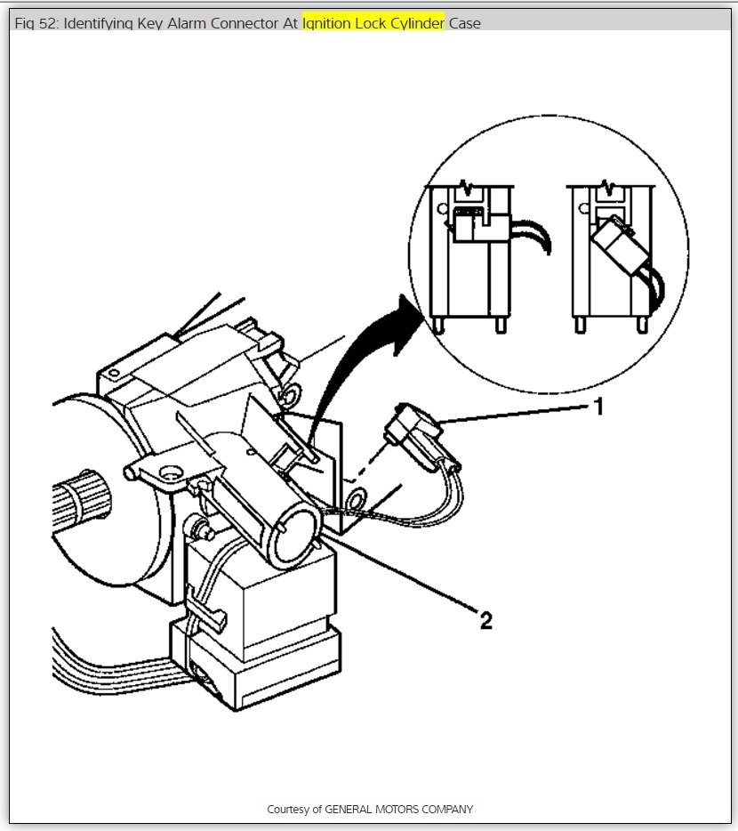

It sounds like the ignition switch tumbler needs replacing. This happens becasue the keys gets worn out due to usage which is normal.
If you get a new tumbler make sure you have the old key made to fit it or the car will not start. You can go to a locksmith and they can make that happen, here are some diagrams that should help you get the repair done.
Please let me know if you need anything else to get the problem fixed.
